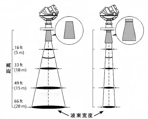

The total beam width of the radar level sensor is inversely proportional to the frequency of the device.
Therefore, for an antenna with the same diameter, if the frequency of the radar level sensor is increased, the beam width will be lower than that of a lower frequency device. The narrow beam minimizes the influence of the nozzle, tank wall and interference.
As shown in the picture (the left side is 6 GHZ, the right side is 26 GHZ).

  1. The lower frequency reduces the sensitivity to steam, foam and antenna contamination. The wave velocity angle of low frequency radar is wider. It can better deal with the problems of steam, dust, condensation, pollution and turbulent surfaces.
  2. The higher frequency can minimize the impact on the nozzle, tank wall and interference.

1: the antenna is different as the 80G mm vawe radar working in 76-81GHz frequency. so the size of antenna is small than 26G Radar, and easy to installation.
2: Small beam angle, as the lenght of wave is 1/3 of 26GHz Radar so the beam taper angle can be controlled smaller, such as 3°
