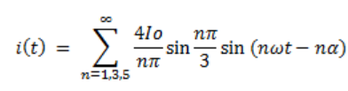

The source current is given by the following relation.
Find the fundamental component of the source current amplitude.
