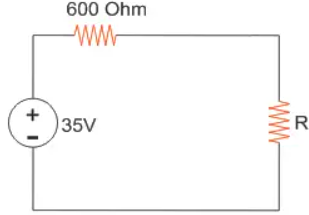

A 35 V source is connected to a series circuit of 600 Ω and R as shown.
If a voltmeter of internal resistance 1.2 kΩ is connected across 600 Ω resistor, it reads 5 V.
The value of R is
A. 2.4 k Ω.
B. 1.2 k Ω.
C. 3.6 k Ω.
D. 7.2 k Ω.
Answer: A
