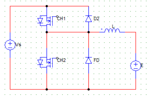

A type C chopper is operated with only negative load ___
A type C chopper is operated with only negative load current.
Negative Load Current
Choose the correct statement.
A. CH1 would remain idle
B. FD would remain idle
C. CH2 would remain idle
D. Both FD and CH1 would remain idle
Answer: D
