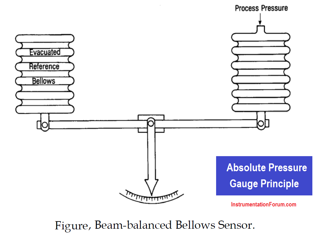

Figure shows an absolute pressure gauge.
Bellows A is evacuated and the process pressure is connected to bellows B.
The gauge will read zero when bellows B is at perfect vacuum and increase as the pressure is increased in bellows B and the low pressure to bellows A.
