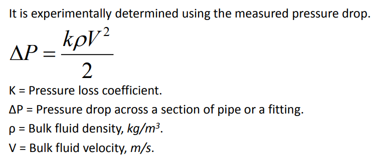

Pressure Drop
- All fittings, obstructions, even pipe itself has a “k factor”.
- The k factor is the pressure loss coefficient for a particular piece of piping.
- For natural gas applications, most plate flow conditioners have a K factor of approximately 2.
- Tube bundles are closer to 0.75 – 1.5.
- What if we are worried about the pressure drop across the flow conditioner?
