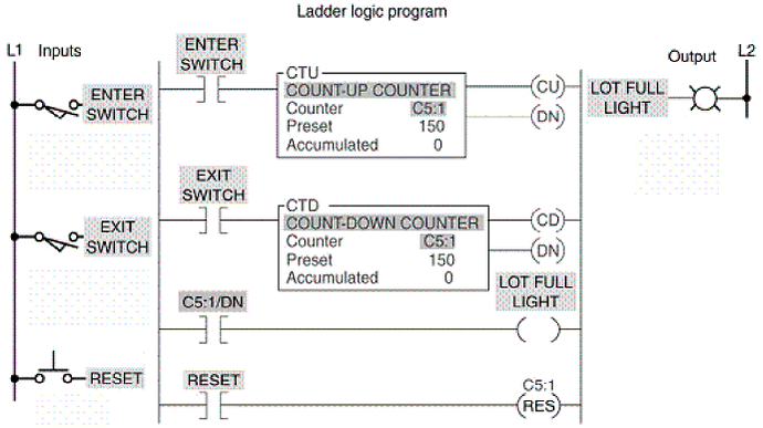

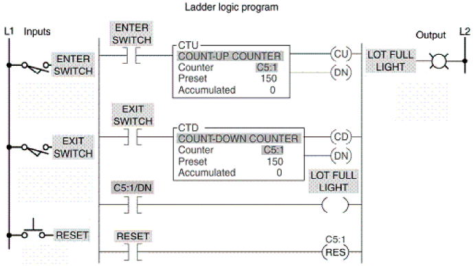

Assume the accumulated count is 100 and the following order of ___
Assume the accumulated count is 100 and the following order of events then occurs:
Exit switch input is actuated 20 times, Reset input is actuated 10 times, and Enter switch input is actuated 5 times.
After this sequence, the accumulated count would be:
A. 100.
B. 115.
C. 5.
D. 0.
Answer: C
