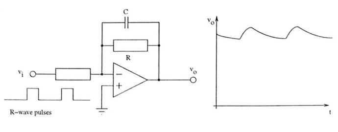

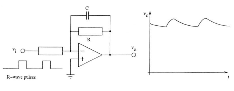

The “average power” of the pulse train from the pulse generator circuit will be indicative of the Heart Rate.
This can be determined using a “leaky integrator” (a form of low-pass filter).
The time-constant of the R-C circuit should be several beats long to minimise output ripple.
