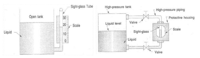

SIGHT GLASS / GAUGE GLASS
Sight glass is used for the continuous indication of liquid level within a tank or vessel. A sight glass instrument consists of a graduated tube of toughened glass which is connected to the interior of the tank at the bottom in which the water level is required.
Fig. 1 Fig. 2
Fig.1 shows a simple sight glass for an open tank in which the liquid level in the sight glass matches the level of liquid in the tank. As the level of liquid in the tank rises and falls, the level in the sight glass also rises and falls accordingly. Thus, by measuring the level in the sight glass, the level of liquid in the tank is measured. In sight glass, it is not necessary to use the same liquid as in the tank. Any other desired liquid also can be used.
Fig.2 shows a high pressure sight glass in which measurement is made by reading the position of the liquid level on the calibrated scale. This type of sight glass in high pressure tanks is used with appropriate safety precautions. The glass tube must have a small inside diameter and a thick wall.
Advantages
Direct reading is possible
Special designs are available for use up to 316°C and 10000 psi.
Glassless designs are available in numerous materials for corrosion resistance.
Disadvantages
It is read only where the tank is located, which is not always convenient.
Overlapping gauges are needed for long level spans
Accuracy and readability depend on the cleanliness of glass and fluid

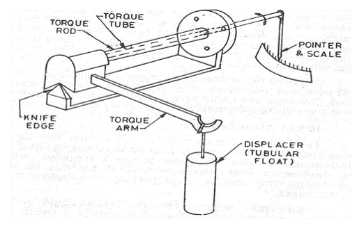

FLOAT DISPLACEMENT TYPE LEVEL MEASUREMENT
These instruments work on the Archimedes principle according to which a body when placed in a liquid is buoyed up by a force equal to the weight of the displaced liquid, and the apparent change in weight of the body is directly proportional to the level of liquid in which it is placed.
Torque tube is the most commonly used device for this purpose.
The displacer is attached to a torque tube assembly whose rotary motion is used for read out/control.
Otherwise, this instrument is rugged and simple in construction and reliable in operation. With selection of suitable material for float, float cage, and torque tube, it’s possible to use this instrument over a wide range of pressure and for many liquids.
Float Displacement Type Level Measurement
Advantages
High accuracy
Reliable in clean liquids
Can be mounted internally or externally (external mounted unit can be disconnected for maintenance)
Adaptable to liquid interface measurement
Disadvantages
Limited range, devices exceeding 1.2m in length are bulky and difficult to balance
Cost increases appreciably for externally mounted units as pressure ratings increase
External units may require stilling chambers

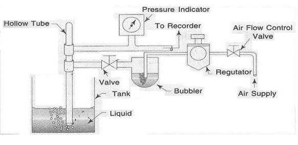

a. Air purge system
Air purge (bubbler tube) is one of the most popular hydrostatic pressure types of liquid measuring system which is suitable for any liquid as shown in fig.
Advantages
Pressure gauge can be placed above or below the tank level and can be kept as far away as 500 ft (12.7m) from the tank with the help of piping.
Well - suited for measuring the corrosive/abrasive liquid.

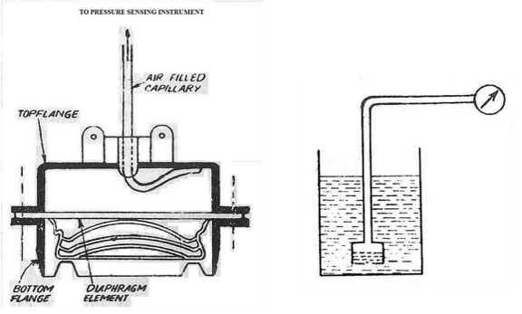

b. DIAPHRAGM BOX METHOD
The diaphragm box liquid level meter is shown in fig. and consist of two flanges in between which is contained a diaphragm element made of rubber or oil resistant synthetic composition.
Advantage
Where it is necessary to prevent contact b/w liquid and diaphragm, the box may be installed in a well outside the tank and the well is communicated to the tank with an impulse piping. The impulse piping and the well are filled with an inert liquid.
Disadvantage
The main disadvantage is that the head developed is not sufficient to meet up the line losses as well as for a satisfactory indication. Hence ranges are quite limited.
