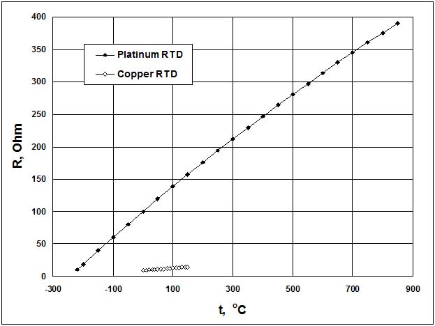

For metals this coefficient is positive. Fig.1 shows relationship between resistance of platinum and copper RTD and temperature.
Platinum RTDs are used for temperature measurements from -220 to 850 oC (they are used as reference RTDs, as well), copper RTD - from -50 to 150 oC, and Nickel RTD - from -215 to 320 oC.
Figure 1: Resistance vs temperature for platinum and copper RTD.

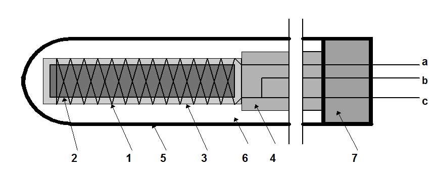

Fig. 2 shows the assembly of RTDs. Sensitive elements of RTDs are made of a thin wire 1 with outside diameter equal to 0.025 mm (platinum RTD) and 0.1 mm (copper RTD) double wounded (non-inductive) on a micaceous or porcelain stem 2. For mechanical strength the sensitive element is placed in the ceramic insulator tube 3 filled by extremely fine granular powder; extension wires are placed in the ceramic insulator 4, and entire assembly is covered by a protective sheath of stainless steel 5. The space between the sheath and ceramic insulator is filled by ceramic packing powder 6. To avoid contact of sensitive element with environment, sensitive assembly is protected by high-temperature hermetic seal 7. The contact between the wire of the sensitive element and the ceramic encapsulation permits a rapid speed of response.
Figure 2: RTD assembly.
