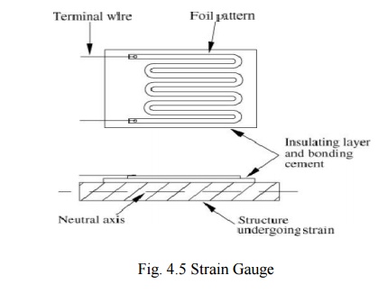

Earlier wire types of strain gauges were used commonly, which are now being replaced by the metal foil types of gauges as shown in the figure below.
The metals can be easily cut into the zigzag foils for the formation of the strain gauges. One of the most popular materials used for the strain gauges is the copper-nickel-manganese alloy, which is known by the trade name ‘Advance.’ Some semiconductor materials can also be used for making the strain gauges.
