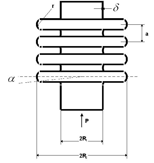

These pressure sensitive elements are usually made of stainless steel; phosphor bronze, brass and are used for pressure measurements for pressures up to 6 MPa. Bellows sensors have large displacement sensitivity.
Figure shows this type of sensor.

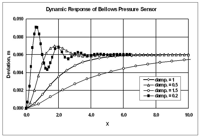

Figure . shows various types of responses of bellows pressure sensor.
