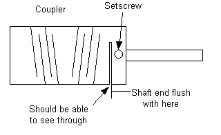

- The shaft should be flush with the right side of the first gap on the coupler (See figure to the right)

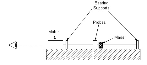

Rotation Direction
The rotation direction, X axis, and Y axis are defined as viewed by the driver (motor) to the driven (shaft). The rotation direction can be confirmed by checking the CW/CCW switch on the back of the Speed Control. The system should be set up to rotate in the CCW direction.
The X and Y axis are defined as follows…

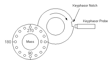

Aligning the Mass
- The system should be set up to rotate CCW when viewed from the motor looking towards the mass.
- Rotate the system in that direction until the leading edge of the keyphasor notch is lined up with the center of the keyphasor probe (see figure to the right)
- Align the 0 degree mark on the mass with the keyphasor probe and tighten both setscrews
