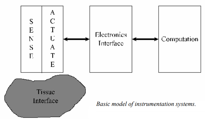

Even though there is a wide variety of instruments, almost all of them can be modeled using the simple diagram below.

Detailed Explanation -
Sensors and Actuators
A sensor must:
• detect biochemical, bioelectrical, or biophysical parameters
• reproduce the physiologic time response of these parameters
• provide a safe interface with biological materials
An actuator must:
• deliver external agents via direct or indirect contact
• control biochemical, bioelectrical, or biophysical parameters
• provide a safe interface with biologic materials
Electronics Interface
The electronics interface must:
• match the electrical characteristics of the sensor/actuator with the computation unit
• preserve signal-to-noise ratio (SNR) of sensor
• preserve efficiency of actuator
• preserve bandwidth (i.e., time response) of sensor/actuator
• provide a safe interface with the sensor/actuator
• provide a safe interface with the computation unit
• provide secondary signal processing functions for the system
Computation Unit
The computation unit must:
• provide primary user interface
• provide primary control for the overall system
• provide data storage for the system
• provide primary signal processing functions for the system
• maintain safe operation of the overall system
