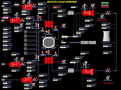

Positive Draught System:
FD Fan is there which is used to suck air from atmosphere and push it into boiler through Air Preheater where it will be preheated with the help of flue gases and then it will helps in carrying the coal to the Boiler (PA Fan) and support for addition Combustion & Turbulence.
If we only used the FD & PA Fan means then in the boiler, pressure will be more than the atmospheric pressure
This is known as Positive Draught System.
If you are using a Two Pass Boiler means after it attaining the reheater region it won’t moves down and heat parts naturally because the density of flue gas will be lighter because it is hot.
So we have to apply more to drive it. i think may one of the disadvantage of the Positive Draught System.
Negative Draught System:
If only ID Fan is available means then it may suck the inside air or Combusted gases from the boiler and push it out through Chimney.
Due to that a Negative pressure may be maintained in the Boiler which may be less than the atmosphere.
Balanced Draught System:
if Both the FD & ID are available and a balanced draft is maintained means then it may be named as a Balanced Draft System.
Nowadays, everyone are using a Balanced Draft System, and maintaining a little low pressure below atmosphere (Negative Draft) that may give an advantage over the system such as explosions & implosion etc.
