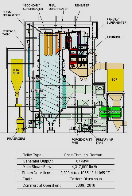

Coal-fired water tube boilers are classified into three major categories: stoker fired units, PC fired units and FBC boilers.

“D” Type boilers
“This design has the most flexible design. They have a single steam drum and a single mud drum, vertically aligned. The boiler tubes extend to one side of each drum.
“D” type boilers generally have more tube surface exposed to the radiant heat than do other designs. “Package boilers” as opposed to “field-erected” units generally have significantly shorter fireboxes and frequently have very high heat transfer rates (250,000 btu per hour per sq foot).
For this reason it is important to ensure high-quality boiler feedwater and to chemically treat the systems properly. Maintenance of burners and diffuser plates to minimize the potential for flame impingement is critical.
