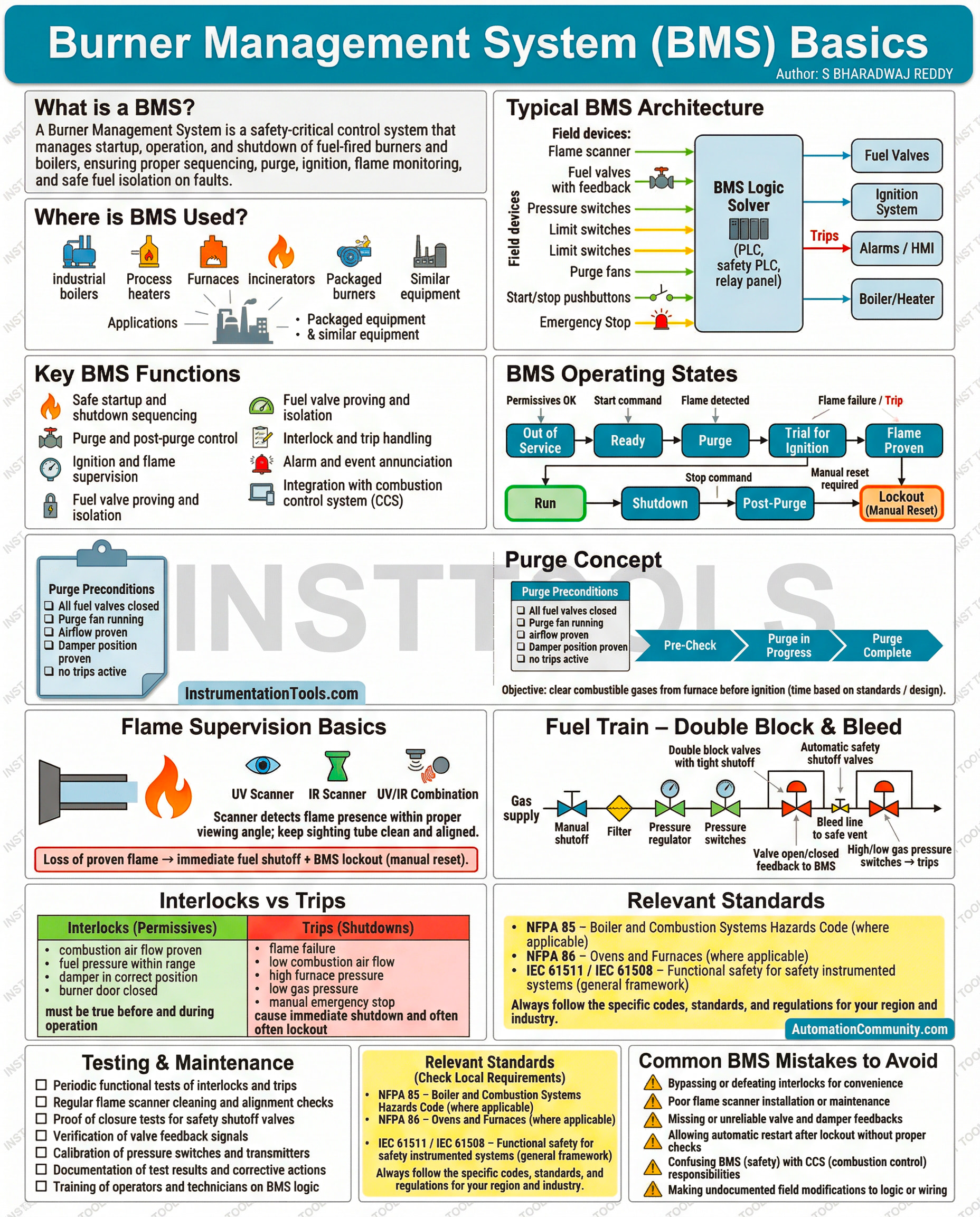

Before a burner starts, one thing matters most:
:backhand_index_pointing_right: Safety first.
That’s exactly what a Burner Management System (BMS) does :backhand_index_pointing_down:
:gear: What is a BMS?
:right_arrow: A safety system used to monitor, start, operate, and shut down burners safely
:right_arrow: Prevents unsafe fuel ignition conditions
:right_arrow: Commonly used in boilers, furnaces, heaters, and incinerators
:brain: Main purpose of BMS
:fire: Prevent explosions
:fire: Ensure safe burner startup
:fire: Monitor flame continuously
:fire: Shut down fuel during unsafe conditions
:rocket: Basic BMS sequence
:one: Purge the furnace with air
:two: Verify all permissives
:three: Ignite pilot burner
:four: Confirm flame detection
:five: Open main fuel valve
:six: Continuously monitor burner operation
:magnifying_glass_tilted_left: Typical BMS inputs
:small_blue_diamond: Flame scanner
:small_blue_diamond: Fuel gas pressure switch
:small_blue_diamond: Air flow switch
:small_blue_diamond: Furnace pressure
:small_blue_diamond: Emergency stop signals
:high_voltage: Typical BMS outputs
:small_orange_diamond: Fuel shutoff valves
:small_orange_diamond: Ignition transformer
:small_orange_diamond: Alarm & trip signals
:small_orange_diamond: Fan controls
:factory: Where BMS is used
:fire: Boilers
:fire: Furnaces
:fire: Thermal oxidizers
:fire: Process heaters
:fire: Gas turbines
:warning: Important safety actions
:police_car_light: Flame failure β†’ Fuel trip
:police_car_light: Low air flow β†’ Burner shutdown
:police_car_light: High furnace pressure β†’ Emergency trip
:bullseye: Key takeaway
:backhand_index_pointing_right: BMS is not for process control
:backhand_index_pointing_right: BMS is for safe combustion control
No flame verification = No fuel allowed
That single logic saves entire plants.
