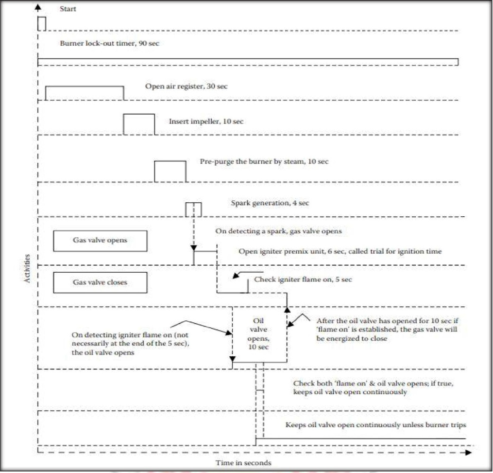

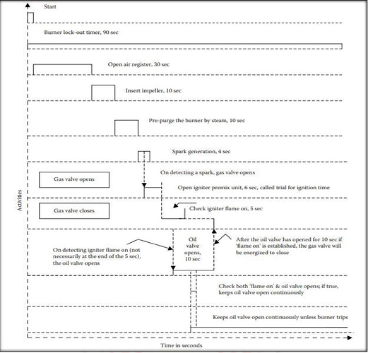

- Timing for a portion of the typical light-off sequence for a 350 MW dual-fired (oil and coal) burner with gas igniter is illustrated in the following figure.
