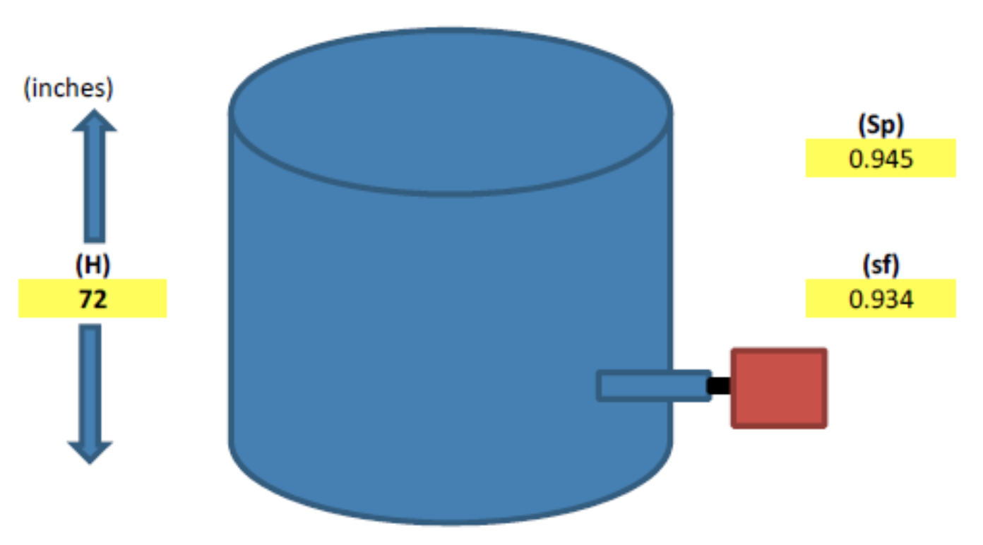

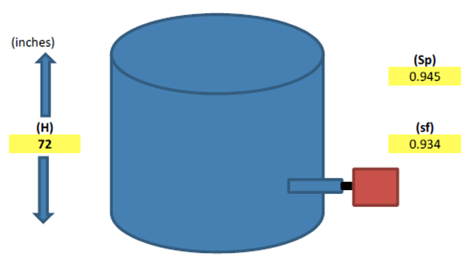

Single Direct Connection With No Suppression or Elevation
| Given values | Calculated values | ||||
| (H) maximum process fluid height (inches) | 72 | Span (inches) | 68.04 | ||
| (Sp) process fluid specific gravity (lb/ft3) | 0.945 | Calibration range values (inches) | 0 | to | 68.04 |
| (h) distance between process connection and transmitter(inches) | No suppression or elevation | ||||
| (sf) fill fluid specific gravity (lb/ft3) | .934 |

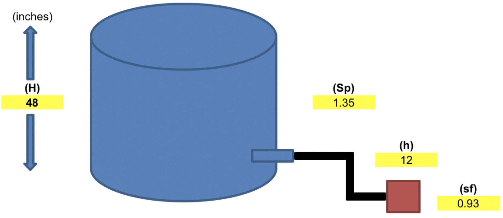

Single Capillary With Zero Suppression
| (H) maximum process fluid height (inches) | 48 | Span (inches) | 64.8 | ||
| (Sp) process fluid specific gravity (lb/ft3) | 1.35 | Calibration range values (inches) | 11.16 | to | 75.96 |
| (h) distance between process connection and transmitter(inches) | 12 | Zero suppression | 11.16 | ||
| (sf) fill fluid specific gravity (lb/ft3) | 0.93 |

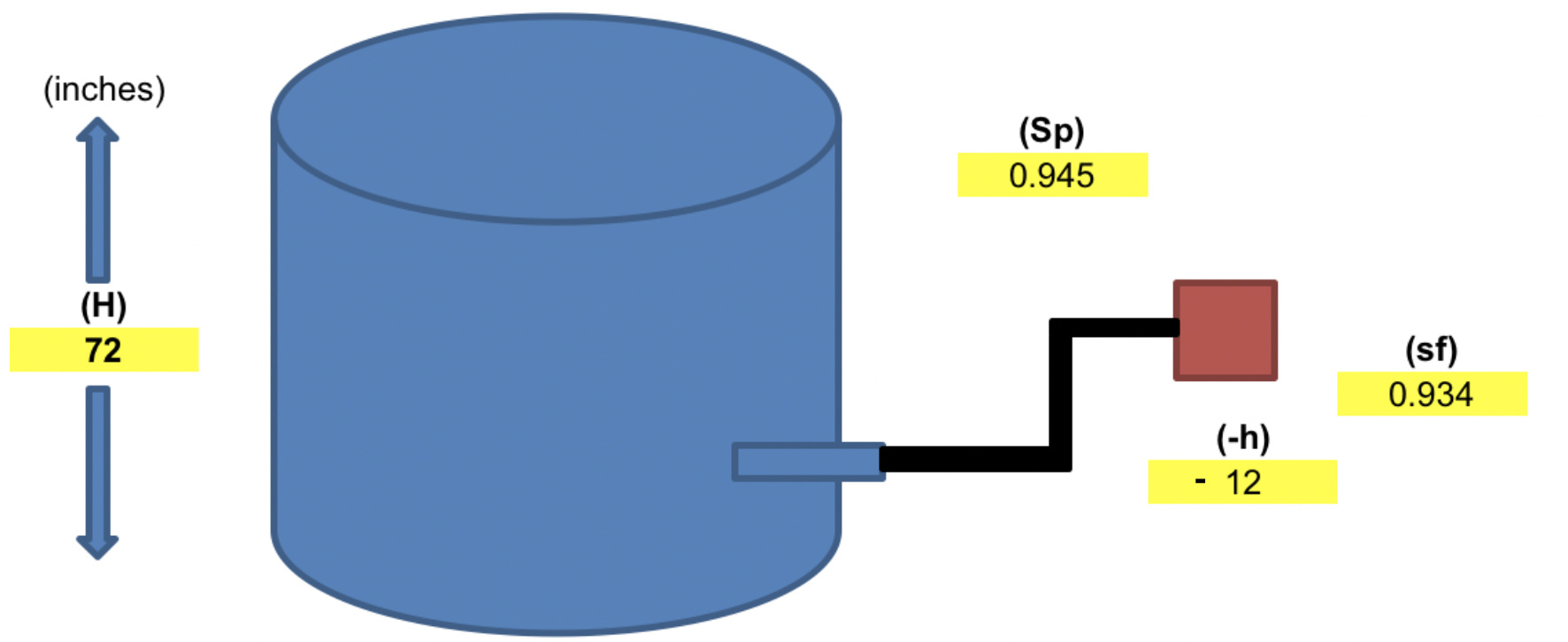

Single Capillary With Zero Elevation
| (Sp) process fluid specific gravity (lb/ft3) | 0.945 | Calibration range values (inches) | -11.2 | to | 56.84 |
| (-h) distance between process connection and transmitter (inches) | -12 | Zero elevation | -11.208 | ||
| (sf) fill fluid specific gravity (lb/ft3) | 0.934 |

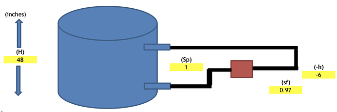

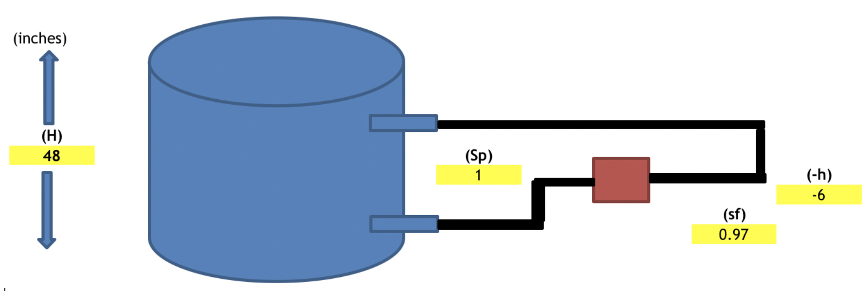

Two Capillary with Zero Elevation
| (H) – maximum process fluid height (inches) | 48 | Span (inches) | 48 | ||
| (Sp) process fluid specific gravity (lb/ft3) | 1 | Calibration range values (inches) | -5.82 | to | 42.18 |
| (-h) – distance between process connection and transmitter(inches) | -6 | Zero elevation | -5.82 | ||
| (sf) – fill fluid specific gravity (lb/ft3) | 0.97 |

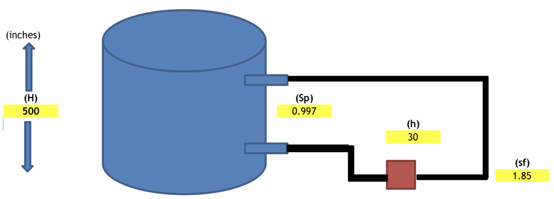

Two Capillary With Zero Suppression
| (H) – maximum process fluid height (inches) | 500 | Span (inches) | 498.5 | ||
| (Sp) process fluid specific gravity (lb/ft3) | 0.997 | Calibration range values (inches) | 55.5 | to | 554 |
| (h) – distance between process connection and transmitter(inches) | 30 | Zero suppression | 55.5 | ||
| (sf) – fill fluid specific gravity (lb/ft3) | 1.85 |
