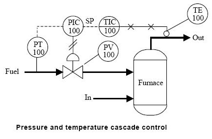

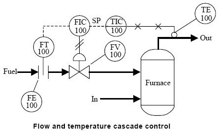

The next two figures illustrate two different cascade control arrangements for a furnace that is used to increase the temperature of a fluid that is passing through it.
In both cases, the primary controlled variable is the same, but in each case a different intermediate controlled variable has been selected. The question then is which type of cascade control is best.
To determine the best cascade control arrangement, you must identify the most likely disturbances to the system. It is helpful to make a list of these in order of increasing importance.
Once this has been done, the designer can review the various cascade control options available and determine which one best meets the overall strategy outlined earlier: to make the inner loop as fast as possible while at the same time receiving the bulk of the important disturbances.
