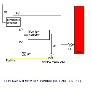

Following a type of cascade control is given
(in this system temperature is controlled by controlling the flow)
Here burner temperature controller is used as master controller and fuel flow controller is used as slave controller where temperature controller’s out put becomes setpoint of the flow controller and finally out put of flow controller goes on the fuel flow control valve
Hence controlling the flow of fuel the burner’s temprature is controlled
