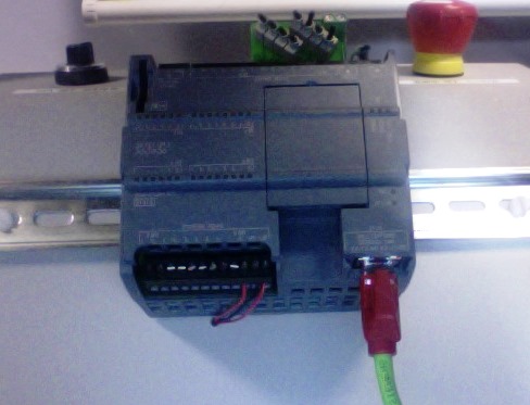

Now we need a hardware test rig that will be used in the working demonstration of Coffee machine.
This is a hardware test rig which is having a processor, where we can download the PLC program. Multiple switches to demonstrate the working of coffee machine switches, Red LED indicator, one Emergency stop button and Ethernet industry cable.

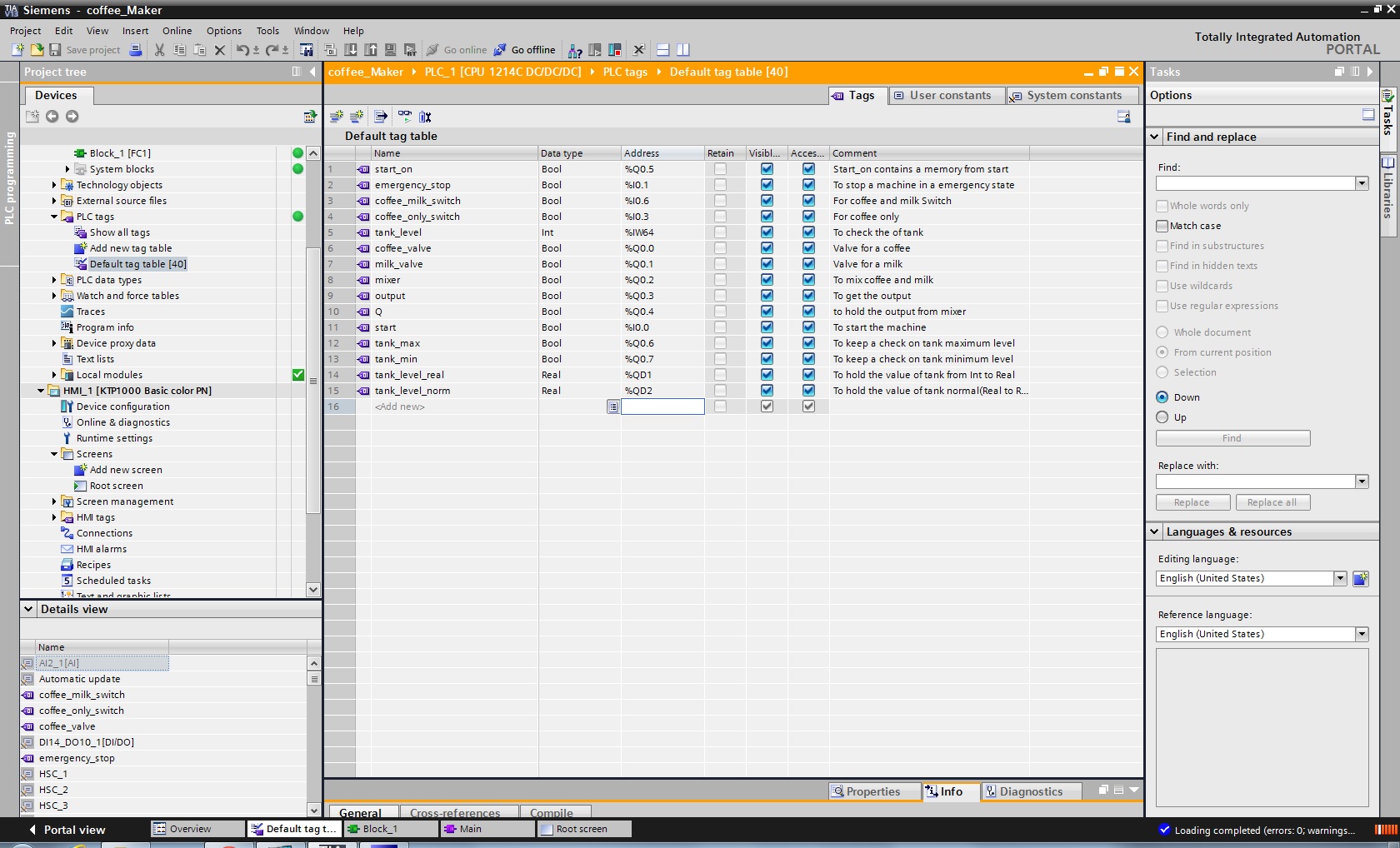

First thing you need to define is the default tags in the default tag table.
This is the default tag table we use to define all the global variables and these global variables are input and output with the descriptive comments and will be used throughout the program in all the blocks.

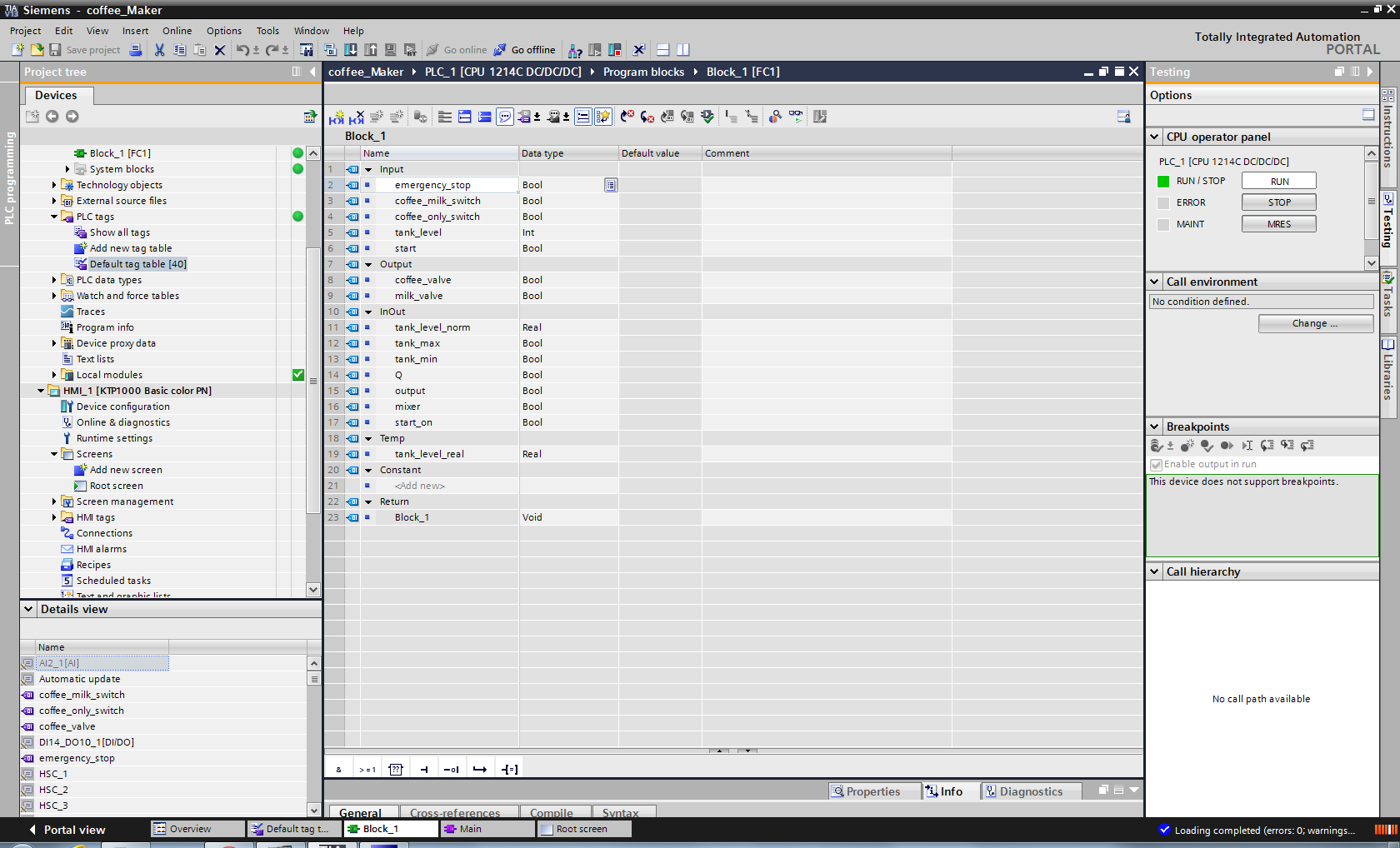

Once the global variable is defined then we need to define the local variables.
These are all the local variables which are going to use in program press.

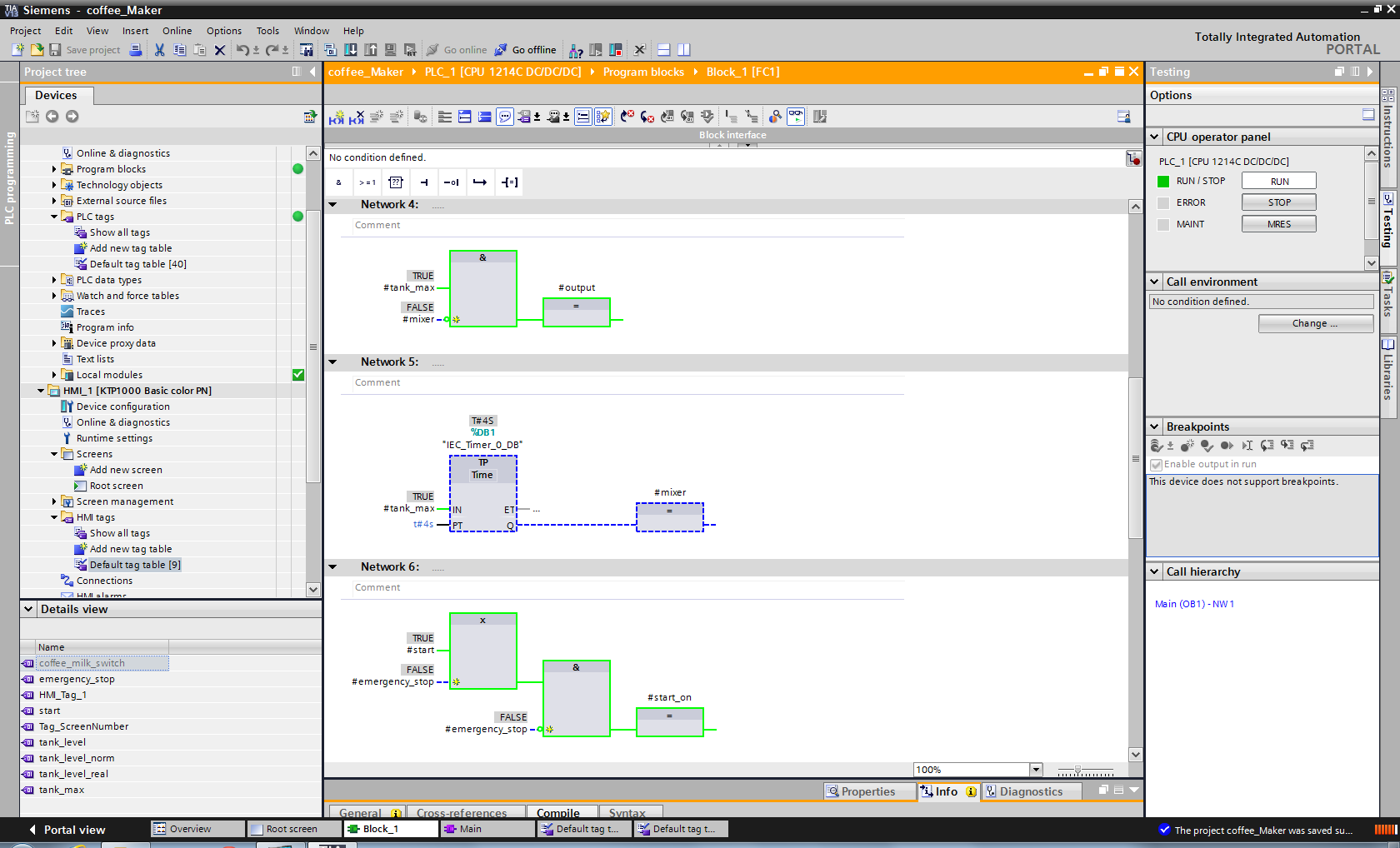

Now after all the global and local variables are defined now we can start assembling the program. The following networks are designed in the network overview within step 7.
The network was designed by dragging building blocks from the library on the right side of the window. Then the local variables are used in the building blocks to describe the functionality of the building blocks and the program can be tested according to its functionalities.

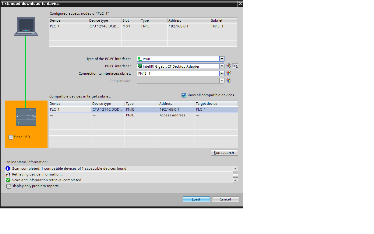

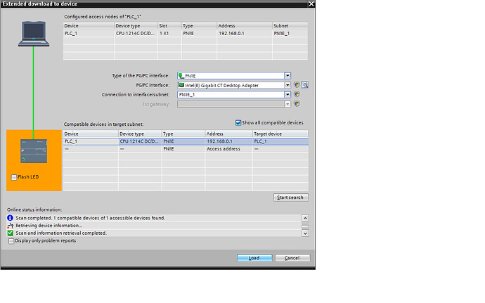

Before we start testing, the program had to be compiled before upload to the PLC. The program can be compiled by pressing the small download button on the toolbar. This result in a screen showing the progress of program compilation. Once the compilation is completed, program will automatically launch into the above window.
When the correct configuration and network information is entered when prompted by the software, a green line is being displayed in the window between the symbol of operating system and symbol of the PLC.
Then the downloading of the program into PLC is done by the pressing load button. Once this completed, the program can be tested. The test view in initiated by pressing the test button which is shown in the next image.
Step%207%20Test%20Button

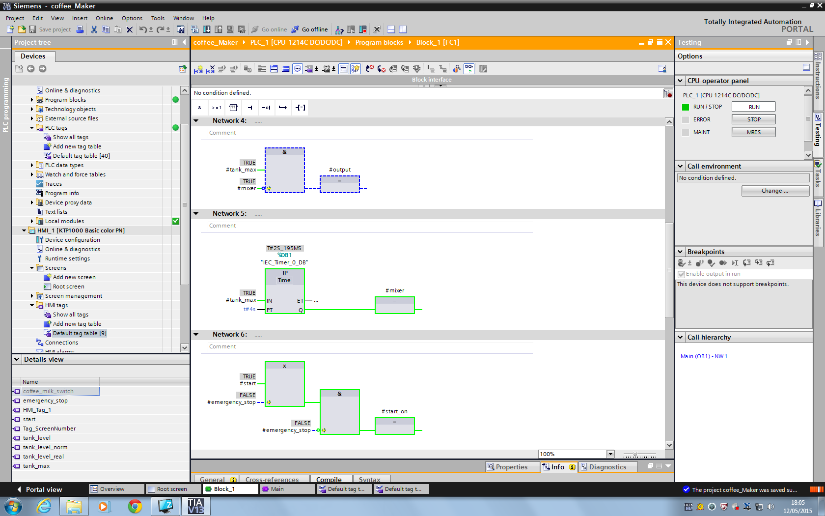

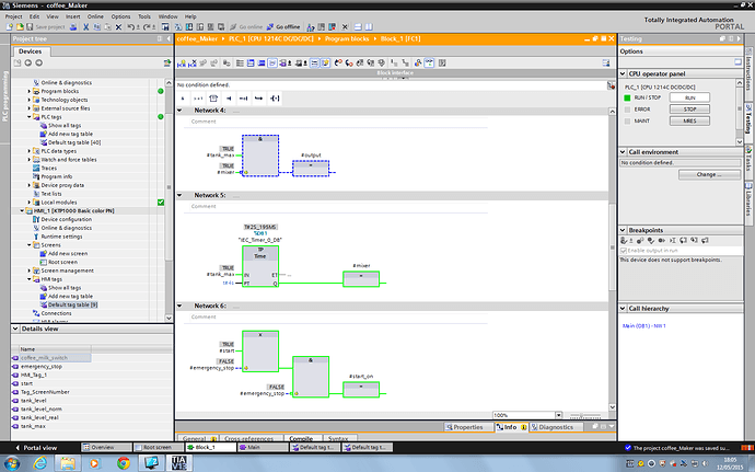

In this window you can see that in network 6 the author used X-OR and & gate to make the Start and Emergency Stop logical circuit. Which is further going to be use as a input to start a machine.

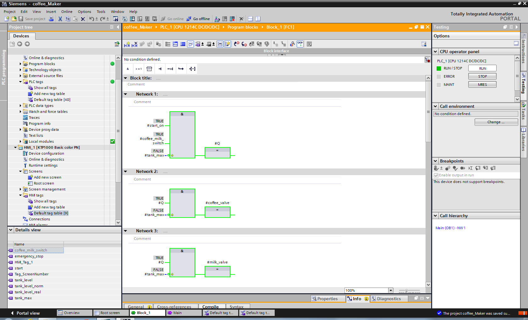

After the machine is started the user need to select from two options coffee and milk and coffee only, in this fig the author used coffee and milk option. Now we can see that both the valves for coffee and milk are open and the coffee and milk is collected in the mixer.
Now the mixer is connected with the tank which monitored the minimum and maximum level of the mixer. As the content in the mixer goes to maximum level both valves of coffee and milk will be closed.

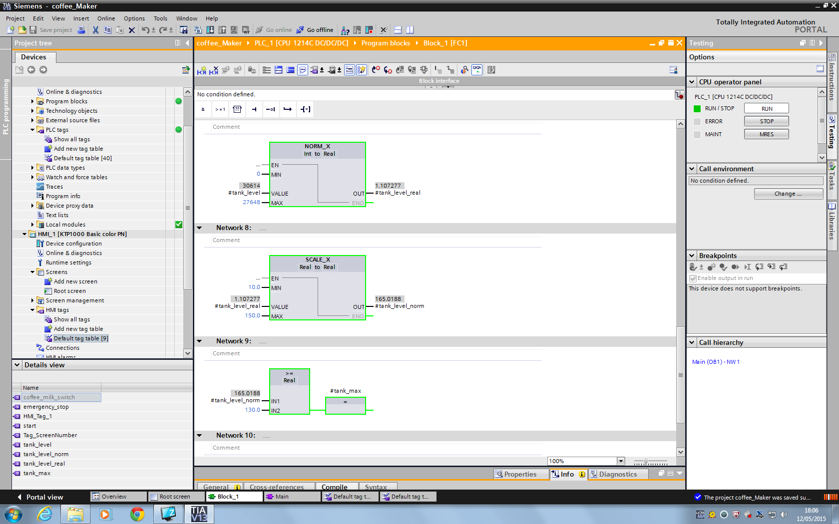

As you can see in this fig the author used two logical circuits to convert the tank data from analog to digital, as the level of tank is above the maximum level and logical circuit of tank maximum goes on.
After the tank level goes to maximum level it will close the valves for coffee and milk and it will start the mixer and the mixer is having a timer of 4 second which means the mixer going to mix the coffee and milk for 4 seconds.
Now in this fig you can see that the mixer goes on with timer. After 4 seconds goes off automatically and after mixer goes off it will open the valve for the output and generate the desired result.
Now as you can see in this fig after 4 second the mixer goes off automatically and the program is producing the desired output.

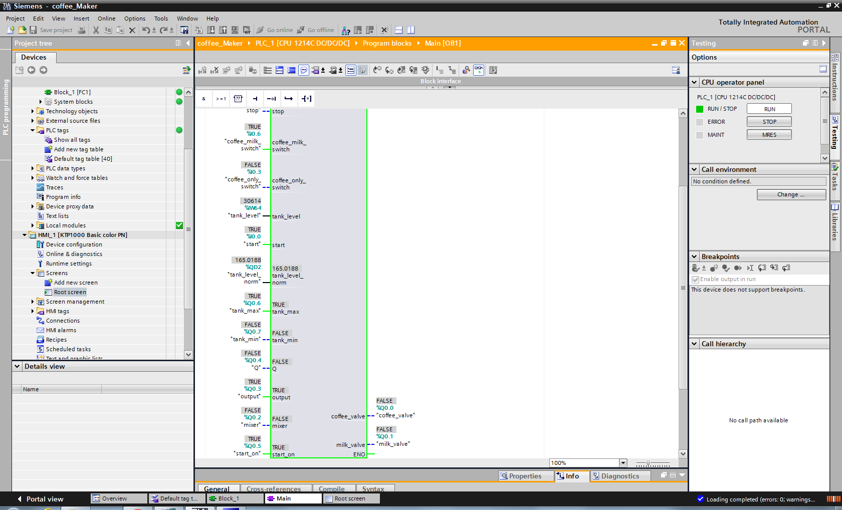

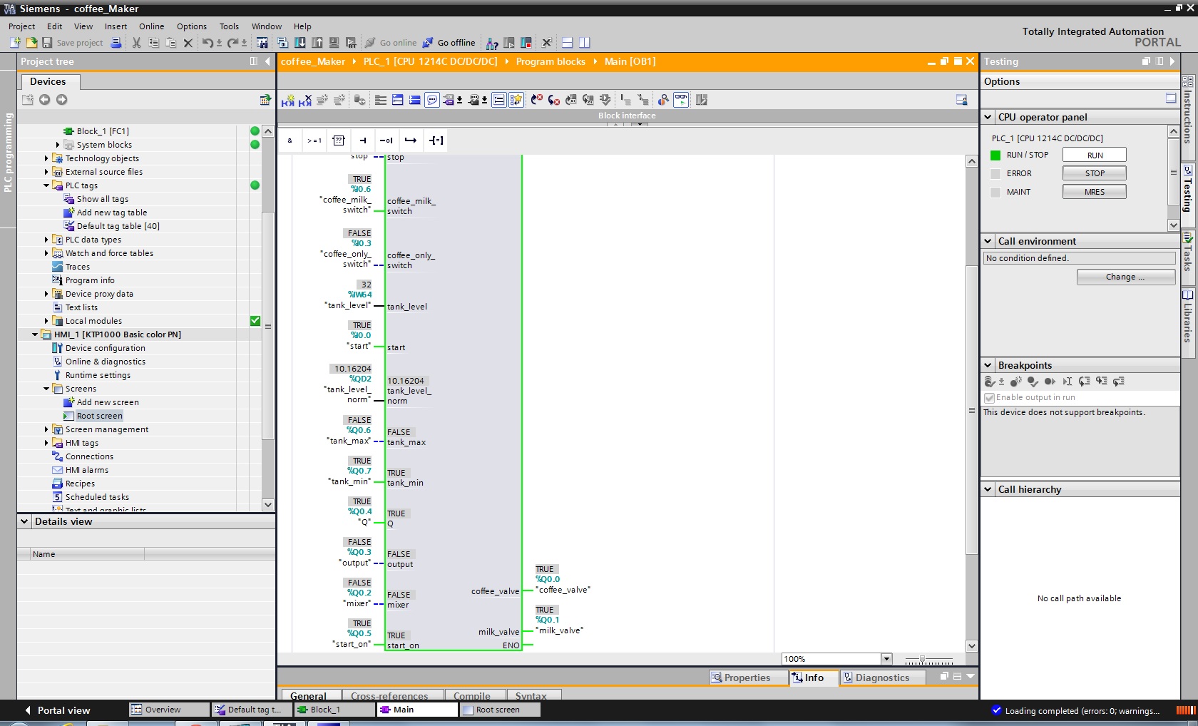

Main Function Block

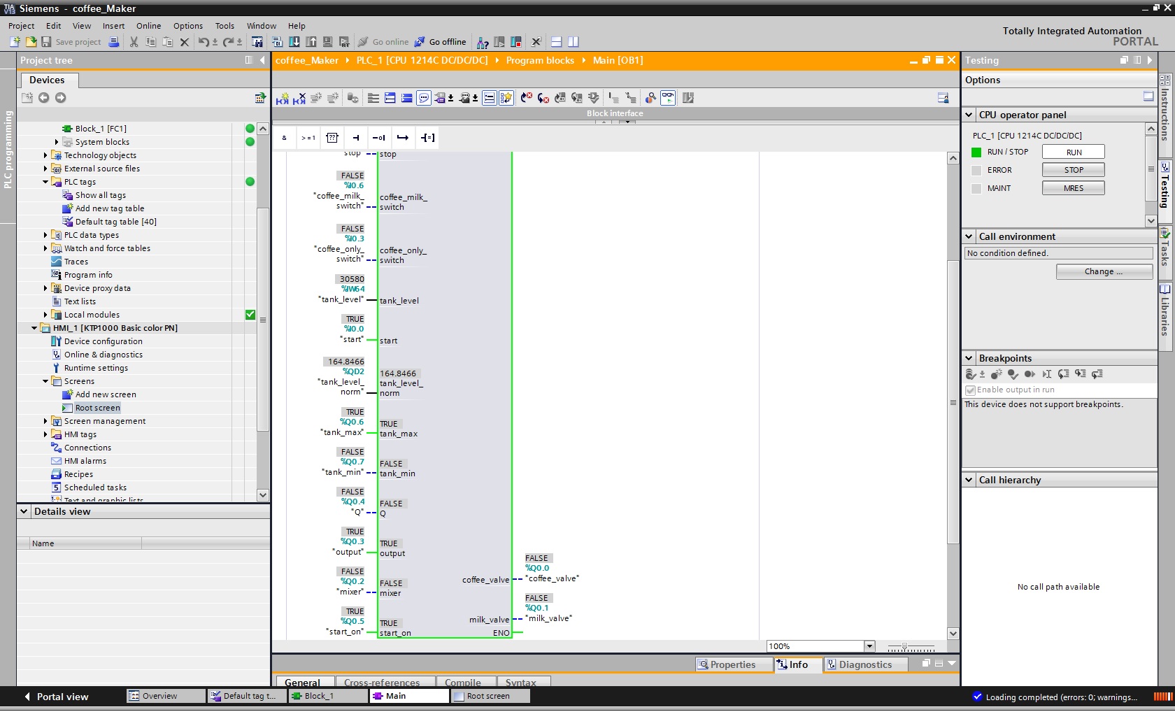

In this figure the Main[OB1] was opened in the network overview, this function block was dragged from the program blocks from left of the screen into the main operation block.
The input and output of this block is required to assign the parameters but these are not local variable which we used before, these are global PLC tags. As you see in above image thee tags were assigned and the program is completed and project is saved.
Now after downloading this program to the device to check the program is working or not, we need to start machine as the start options goes true it means that the machine is ready to use as you can see in the image above.
Now as you can see both the options coffee and milk and coffee only is showing false it means it has to be in a true condition for further process of the machine as the user select one of the option, for example the user select coffee-milk, which makes coffee and milk goes true and opens the valve for both coffee and milk, as you can see in the above image.
Now as the tank level goes to maximum level both the valves goes off and it starts the mixer and it set the mixer on a true condition for four seconds because the mixer is bound with the timer which makes the mixer true for four seconds.
Now you can see in the above image the mixer goes off after four seconds and the program produce the desired result and the output is showing true condition.

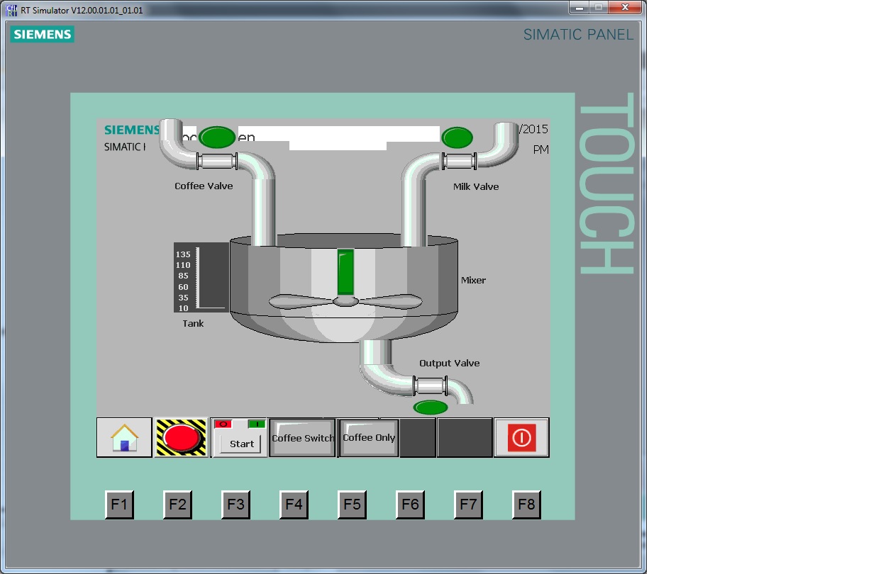

HMI Program Design

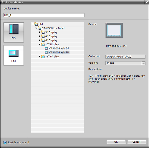

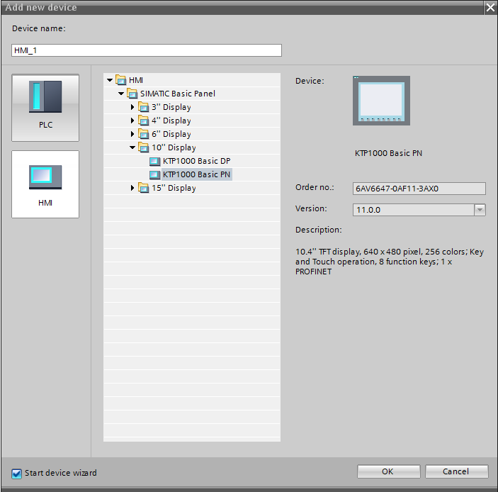

Before we start with the HMI design the software want to know what model of HMI is going to be used. By adding the new device into the program we can add a HMI display and then configured the HMI display specifications, as is shown in the image below.

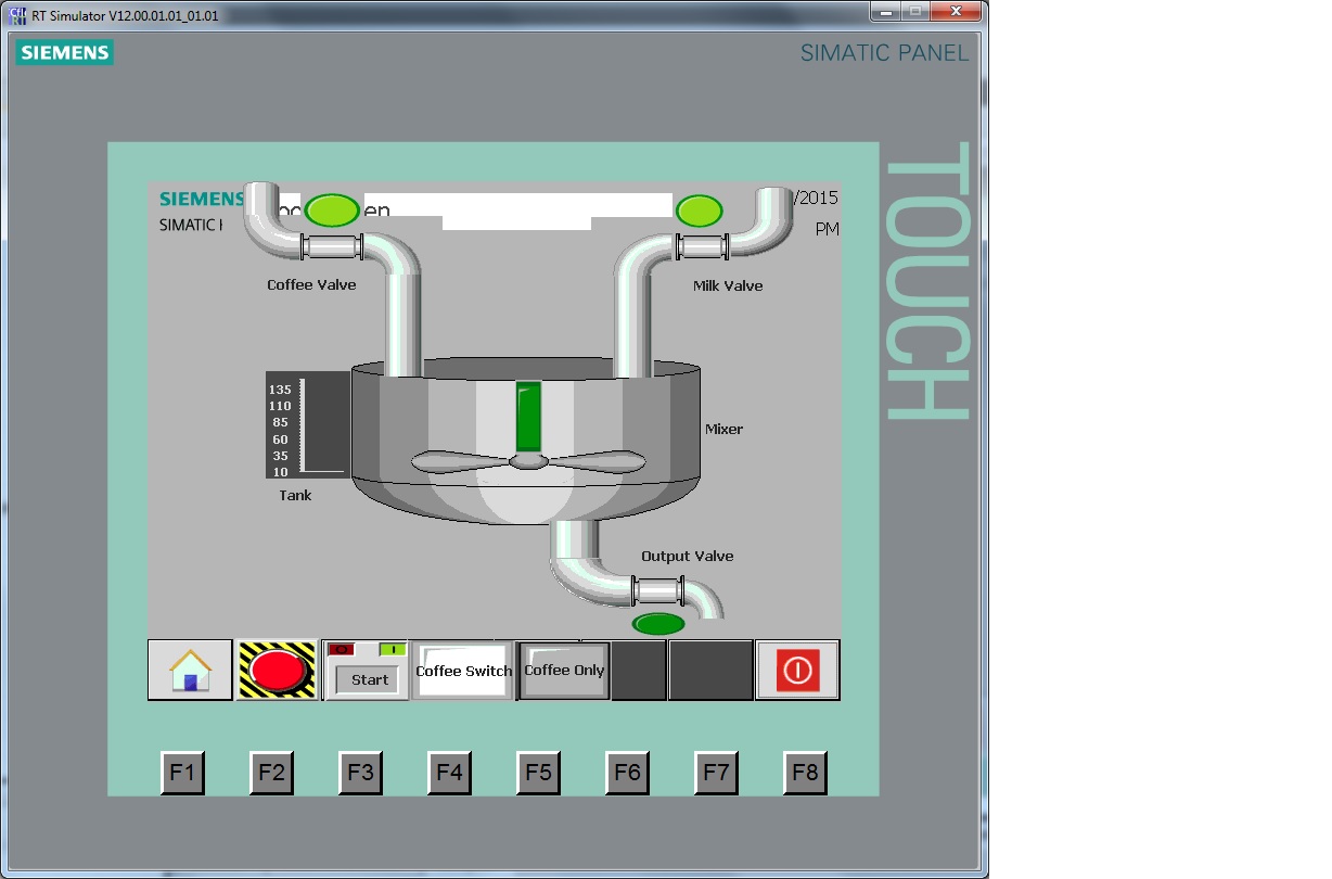

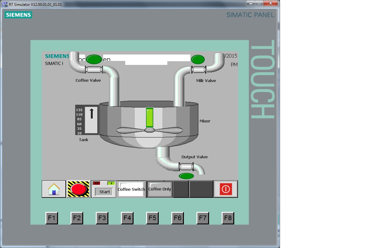

The step 7 provides wide variety of graphics in its library that can be used in the display for the design. In the HMI overview screen you can see the author use the best suitable available graphics from the library.

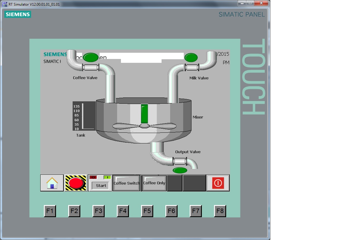

This is the display of the coffee machine which is having an Emergency stop button, a start button, Coffee (coffee-milk) button and coffee only button, it is also showing three valves for coffee, milk and output valve, each valve is associated with an indicator light, which will only stay ‘on’ when the valves of the corresponding light is in active state.
There is also a tank, showing the level of content in the mixer. The machine showing is in a idle state because all the light corresponding to their function is not is a active state.

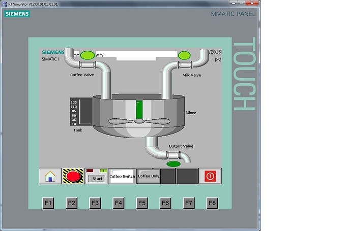

As shown in the above image the start button has been pressed to start the machine, the green light of the start button appears to be in a ‘on’ state. Now the user needs to select from the options.

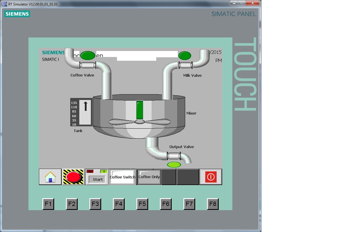

Now the user made his choice by pressing Coffee button, as shown in the image both the valve for coffee and milk is open as it showing the corresponding light of the valves is in a active state and starting to collect in the mixer.
Now you can see, the tank level is showing the mixer reaches the maximum level which directs the valves for coffee and milk to goes off and automatically starts the mixer to mix the content.
As shown in this image the mixer goes off because mixer works with timer of four seconds, as the timer expires, it will open the output valve to produce result.
