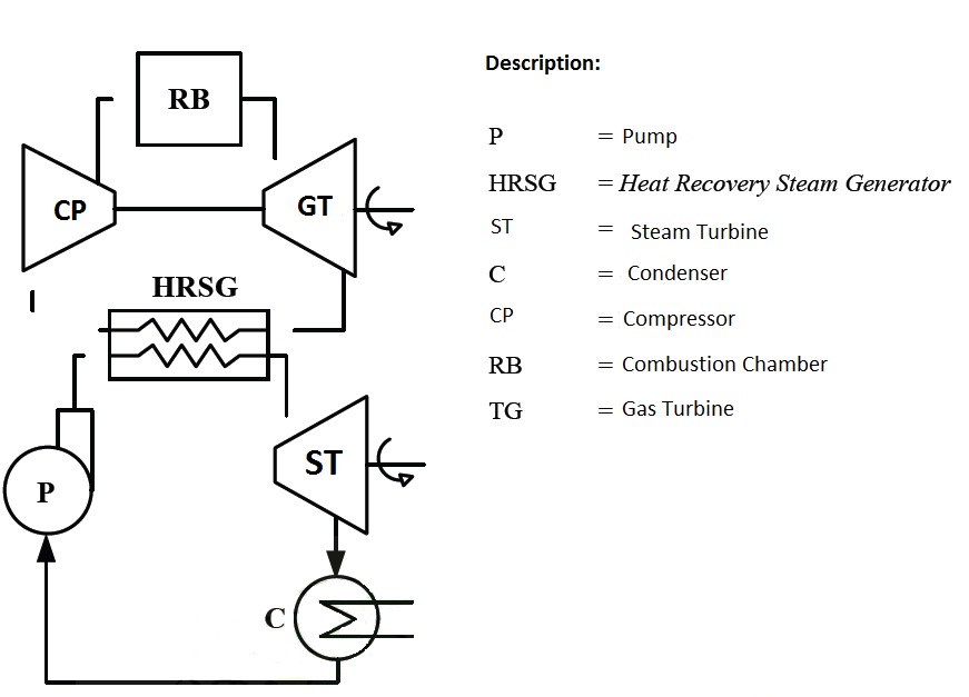

To avoid the matters above, utilization exhaust gases from gas turbine is with HRSG boiler. This can be clearly understood, where the exhaust gases from gas turbine are still contain relatively high energy, which can be utilized as energy source for steam cycle. Therefore, the two cycles can complement each other thermodynamically. Thus it can be combined into one combined cycle power plant consisting of gas turbine and steam turbine that drive each generator separately.
Figure 1: Combined Cycle Power Plant
Combined cycle power plant as shown in Figure 1 above, in addition to producing high efficiency and greater power output, combined cycle is flexible, easily ignited with no full load, suitable for base load operation and turbine has cycle and has high efficiency in wide load area. The disadvantage is associated to is complexity because basically of installation of two combined technologies in complex power plant.
