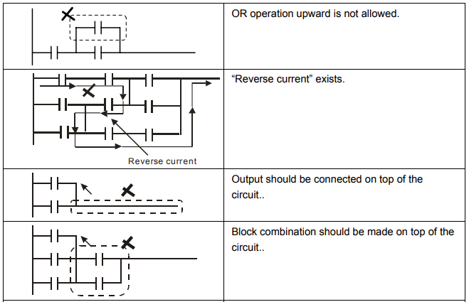

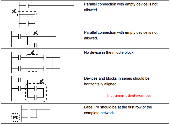

PLC processes the diagram program from up to down and left to right. When editing ladder diagram users should adopt this principle as well otherwise an error would be detected by Software when compiling user program.
Common program errors are listed below:
