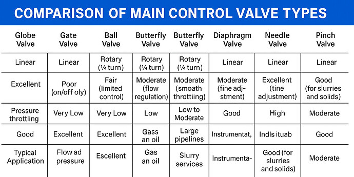

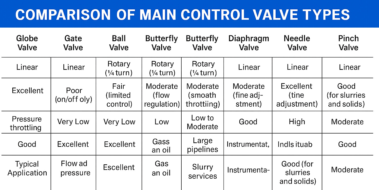

Comparison of Main Control Valve Types
| Valve Type | Motion Type | Flow Control Capability | Pressure Drop | Shutoff Tightness | Typical Application | Main Advantages | Limitations / Disadvantages |
| Globe Valve | Linear | Excellent (precise throttling) | High | Good | Flow and pressure control in process lines | Accurate control, predictable flow characteristics, easy maintenance | Higher energy loss, heavier and costly |
| Gate Valve | Linear | Poor (on/off only) | Very Low | Excellent | Pipeline isolation and block valves | Full bore flow, minimal resistance | Not suitable for throttling, slow operation |
| Ball Valve | Rotary (¼ turn) | Fair (limited control) | Very Low | Excellent | Gas, oil, and clean liquid service | Quick operation, tight shutoff, compact design | Seat damage during throttling, not precise |
| Butterfly Valve | Rotary (¼ turn) | Moderate (flow regulation) | Low | Good (with soft seat) | Large-diameter pipelines, air, water, HVAC | Lightweight, low cost, compact | Not ideal for high pressure or precise control |
| Plug Valve | Rotary (¼ turn) | Good (some throttling) | Low to Moderate | Good | Corrosive fluids, slurries, viscous liquids | Quick action, good sealing, simple design | High torque, lubrication required |
| Diaphragm Valve | Linear | Moderate (smooth throttling) | Moderate | Excellent | Corrosive, abrasive, and slurry services | Leak-free operation, simple construction | Limited pressure/temp range, diaphragm wear |
| Needle Valve | Linear | Excellent (fine adjustment) | High | Good | Instrumentation and sampling lines | Precise low-flow control, compact | Not suitable for large flow rates |
| Pinch Valve | Linear | Good (for slurries and solids) | Moderate | Good | Mining, wastewater, pulp and paper | Handles solids, simple maintenance | Limited pressure and temperature rating |
Key Insights
Globe valves are preferred for true control applications due to their accurate throttling.
Ball and gate valves are best for on/off isolation where tight shutoff is required.
Butterfly valves dominate large line size and low-pressure services.
Diaphragm and pinch valves excel in slurry or corrosive service where tight sealing and non-contamination are critical.
Needle valves are used for precision flow in instrumentation lines.
