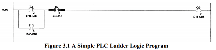

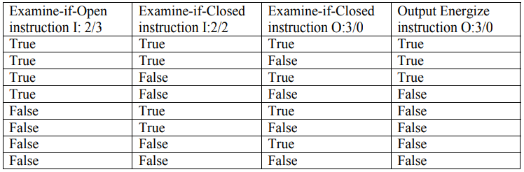

In Figure 3.1, the status of Output Energize instruction O:3/0 depends on the statuses of the Examine-if-Open instruction I:2/3 and the Examine-if-Closed instructions I:2/2 and O:3/0. In the following table, the first three columns of each row list a logic status combination of the Examine-if-Open instruction I:2/3 and the Examine-if-Closed instructions I:2/2 and O:3/0. The last column of that row shows the corresponding logic status of the Output Energize instruction O:3/0.
In the first three rows of the table, there is at least one true path from the left rail to the Output energize instruction O:3/0. Therefore, the Output Energize instruction O:3/0 is true. In the last five rows of the table, there is no true path from left rail to the Output Energize instruction O:3/0. The Output Energize instruction O:3/0 in this case is therefore false.
The ladder logic program in Figure 3.1 is an output latch control. Each of the input terminals I:2/2 and I:2/3 is connected to a normally-open, momentarily-closed push button. A normallyopen, momentarily-closed push button is a control component, whose contacts are open when the button is not pushed. Its contacts are closed when the button is pushed.
The output terminal O:3/0 is connected to the device being controlled, e.g. a motor starter, a heater, a light, or similar device. The push button connected to the input terminal I:2/2 is a START button. When this button is pressed and the button connected to the input terminal I:2/3 is not pressed, the PLC finds a true path made by the Examine-if-Closed instruction I:2/2 and the Examine-if-Open instruction I:2/3.
So the Output Energize instruction O:3/0 is true now and its memory is updated. This memory updating causes the Examine-if-Closed instruction O:3/0 to be true. Now, releasing the START button does not cause the Output Energize instruction O:3/0 to turn to false, because there is another true path made by the Examine-if-Closed instruction O:3/0 and the Examine-if-Open instruction I:2/3.
The push button connected to the input terminal I:2/3 is a STOP button. When this button is pressed, the Examine-if-Open instruction I:2/3 is false. That will cut off the true path to the Output Energize instruction O:3/0 and de-energize the output.

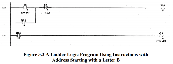

Figure 3.2 is a ladder logic program that does the same function as the one in Figure 3.1. In this program, a bit instruction with the address of B3:1/10 is used. The Output Energize instruction B3:1/10 in Figure 3.2 works similarly to the Output Energize instruction O:3/0 in Figure 3.1. That means B3:1/10 is true when its rung is true, and B3:1/10 is false when its rung is false.
However, a bit instruction with the address beginning with the letter B only affects a memory location. This memory location does not link to an output terminal. Therefore, the status of Output Energize instruction B3:1/10 does not control an output device unless it is also used in another rung(s) of the program for controlling other instruction(s).
The second rung of Figure 3.2 uses the Examine-if-Closed instruction B3:1/10 to control the Output Energize instruction O:3/0. When B3:1/10 is true, O:3/0 is also true. The bit instructions that have addresses beginning with a letter B are used for program internal control.
That allows PLC programmers not to use any output terminal address if there is not a device needed to be controlled by the output instruction.
