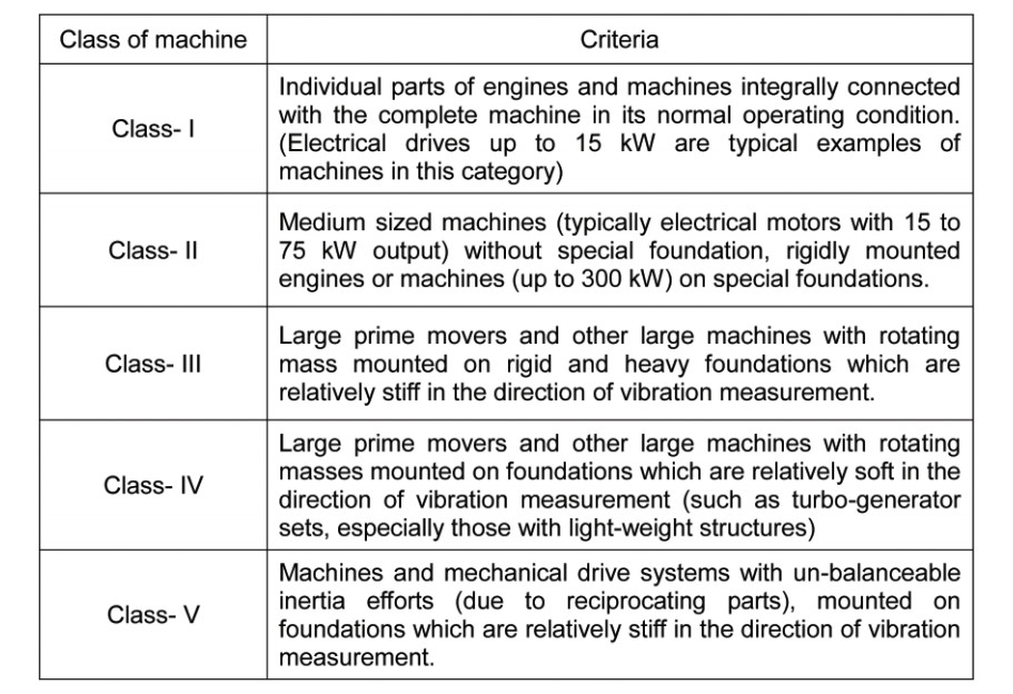

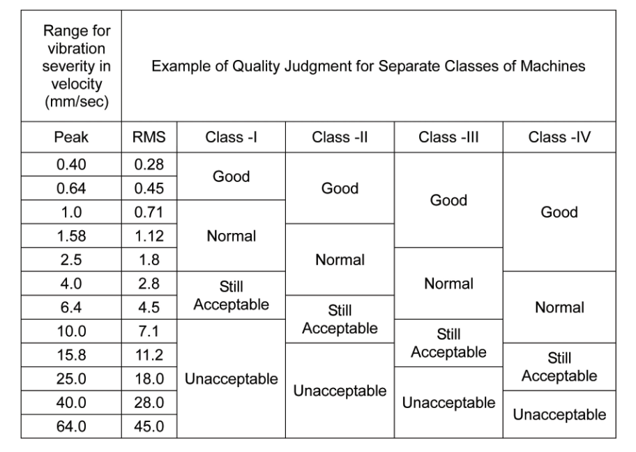

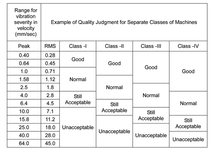

The severity of the vibration is specified by IS 2372, which is measured with reference to class of machine. The criteria for class of machine are given in Table 1 overleaf.
For the above class of machine, the vibration severity can be judged by the guidelines shown in Table 2 overleaf.
Table 1 Criteria for class of machine
Table 2 Vibration severity chart for machine vibration limits

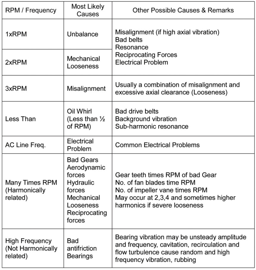

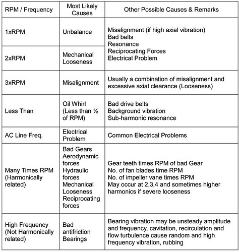

The guidelines for vibration frequencies and likely causes are mentioned in Table 3 overleaf.
Table 3 Vibration frequencies and likely causes
