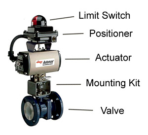

2.Limit switches and solenoid
- Limit switches are mounted on top to operate signal lights for valve position, valve operation or alarm.
- Solenoid valve may be provided for remote loading and unloading of valve.

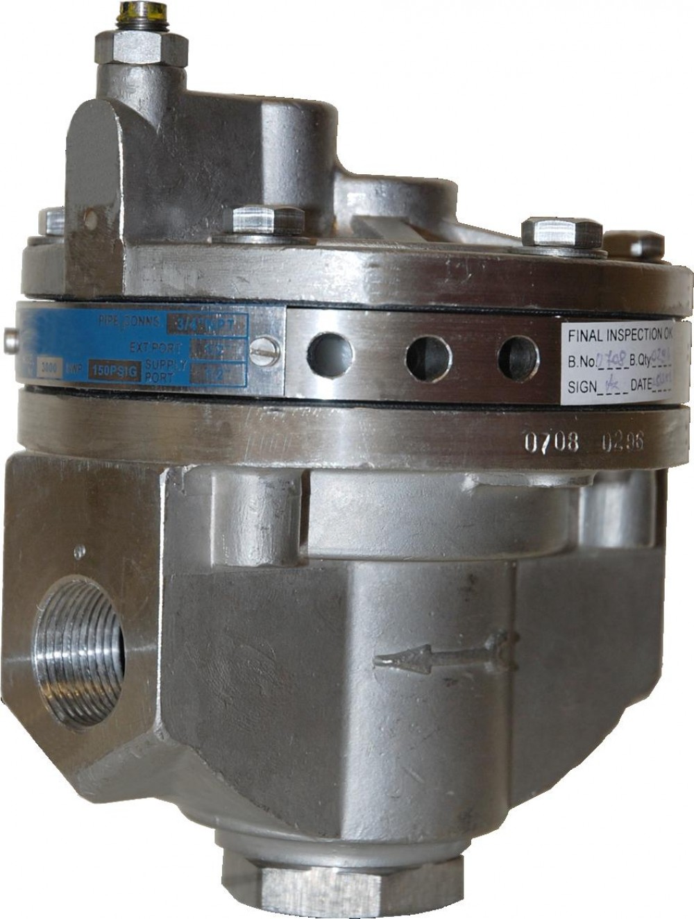

3.Booster relay
- They are used to reduce lag time resulting from long transmission lines or to actuate large diaphragms.

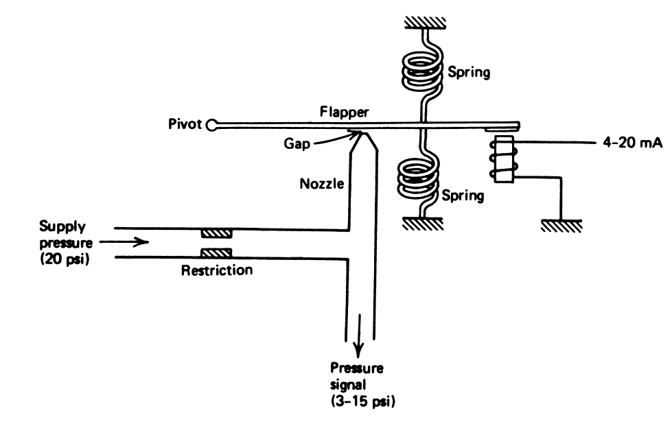

6. Transducers
- Electronic control loops require I/P converter when control valve is pneumatically operated.
