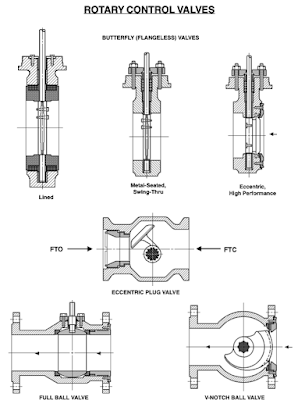

Butterfly valve : A valve with a circular body and a rotary motion disk closure member, pivotally supported by its shaft.

Closure member configurations (plug) :
- Characterized: Closure member with contoured surface, such as the “vee plug,” to provide various flow characteristics.
- Cylindrical: A cylindrical closure member with a flow passage through it (or a partial cylinder).
- Eccentric: Closure member face is not concentric with the stem centerline and moves into seat when closing.
- Eccentric spherical disk: Disk is spherical segment, not concentric with the disk stem.
- Linear: A closure member that moves in a line perpendicular to the seating plane.
- Rotary: A closure member which is rotated into or away from a seat to modulate flow.

Flangeless control valve : A valve without integral line flanges, which is installed by bolting between companion flanges, with a set of bolts, or studs, generally extending through the companion flanges.

Plug valve : A rotary motion valve with a closure member that may be cylindrical or conical. Port: The flow control orifice of a control valve.

- Balve, ball: A valve with a rotary motion closure member consisting of a full ball or a segmented ball.

- Valve, floating ball: A valve with a full ball positioned within the valve that contacts either of two seat rings and is free to move toward the seat ring opposite the pressure source when in the closed position to effect tight shutoff.
