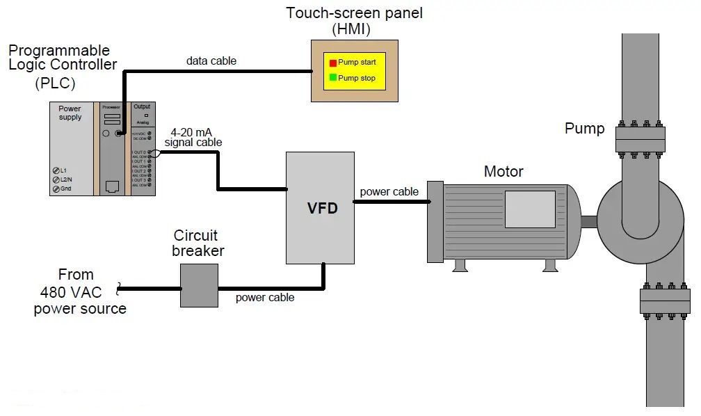

There are five ways to control a Variable Frequency Drive (VFD) with a Programmable Logic Controller (PLC):
Analog Signal Control (0-10V/4-20mA)
- PLC outputs analog signal: 0-10V or 4-20mA.
- VFD receives signal: Adjusts frequency accordingly.
- Common applications: Speed control, ramping, and modulation.

Additional Considerations
- Ensure compatibility: Verify PLC and VFD compatibility.
- Configure communication: Set up communication protocols.
- Program PLC logic: Develop control logic.
- Test and commission: Verify proper operation.
