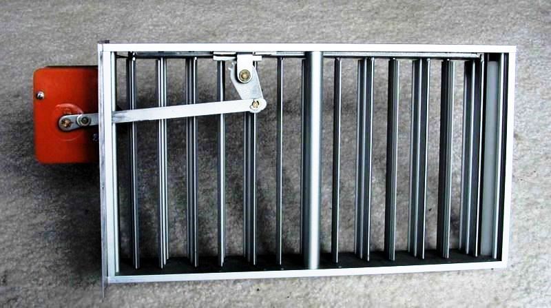

A damper is a valve or plate that stops or regulates the flow of air inside a duct, chimney, variable air volume box, air handler, or other air handling equipment. A damper may be used to cut off central air conditioning to an unused room, or to regulate it for room-by-room temperature and climate control. Its operation can be manual or automatic.
Manual dampers are turned by a handle on the outside of a duct. Automatic dampers are used to regulate airflow constantly and are operated by electric or pneumatic motors, which are in turn controlled by a thermostat or building automation system.
Automatic or motorized dampers may also be controlled by a solenoid, and the degree of air-flow calibrated (perhaps according to signals from the thermostat going to the actuator of the damper) in order to modulate the flow of air-conditioned air in order to effect climate control.
