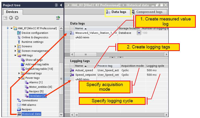

Procedure for configuring data logs
In the “Logging” area navigation in the runtime settings, you configure the logging settings for the fast and slow data logs (tag logs). Here, you specify the period for which the data of “fast data log and slow data log” are logged and the point in time as of which the data can be overwritten. In addition to this, the backup function is also enabled here and the path for swapping out the log segments for backup is entered.
The procedure for the configuration of a tag log consists of the following steps:
- Go to → > Project tree > HMI device > Historical data > Data logs tab
- Create new tag log and select storage location. (By clicking on the entry in an empty table row, a new log is inserted in the configuration. Following this, the log name and storage location for example “Database” and the status at the start of runtime must be selected.
- Select the tags for logging.
- Inspector window > Properties tab (Properties) > General:
o Name: Specify the log name
o Storage location / Storage location: e.g. select “Database”.
o Status: Disable the “Locked” option so that logging is enabled when runtime starts.
As an alternative, the properties of a log can be configured directly in the table of the “Data logs” editor. Columns that are not displayed can be shown using the shortcut menu of the column title.
