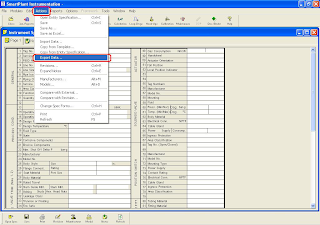

Exporting specification sheet (creating .isf files) – by Intools operator
- Open instrument specification for the specified tag number
- Select “Action” >> “Export Data…”
- You will be prompted the location and file name to be saved. Ensure the file type is Intools Spec Files (*.isf)

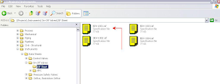

Filling detail data in specification sheet using Intools – by Instrument engineer
- Open windows explorer and go to location where the files are saved. If the Intools external editor has been installed, the file will be readable.
- Open the the file and fill the data sheet as necessary, and do not forget to save once finished.
Importing specification sheet – by Intools operator
- Select “Action” >> “Import Data…”
- You will be prompted the source file to be imported. Note: The tag number should match otherwise it will fail to import.
- Wait for a moment since Intools progressing importing the data.
