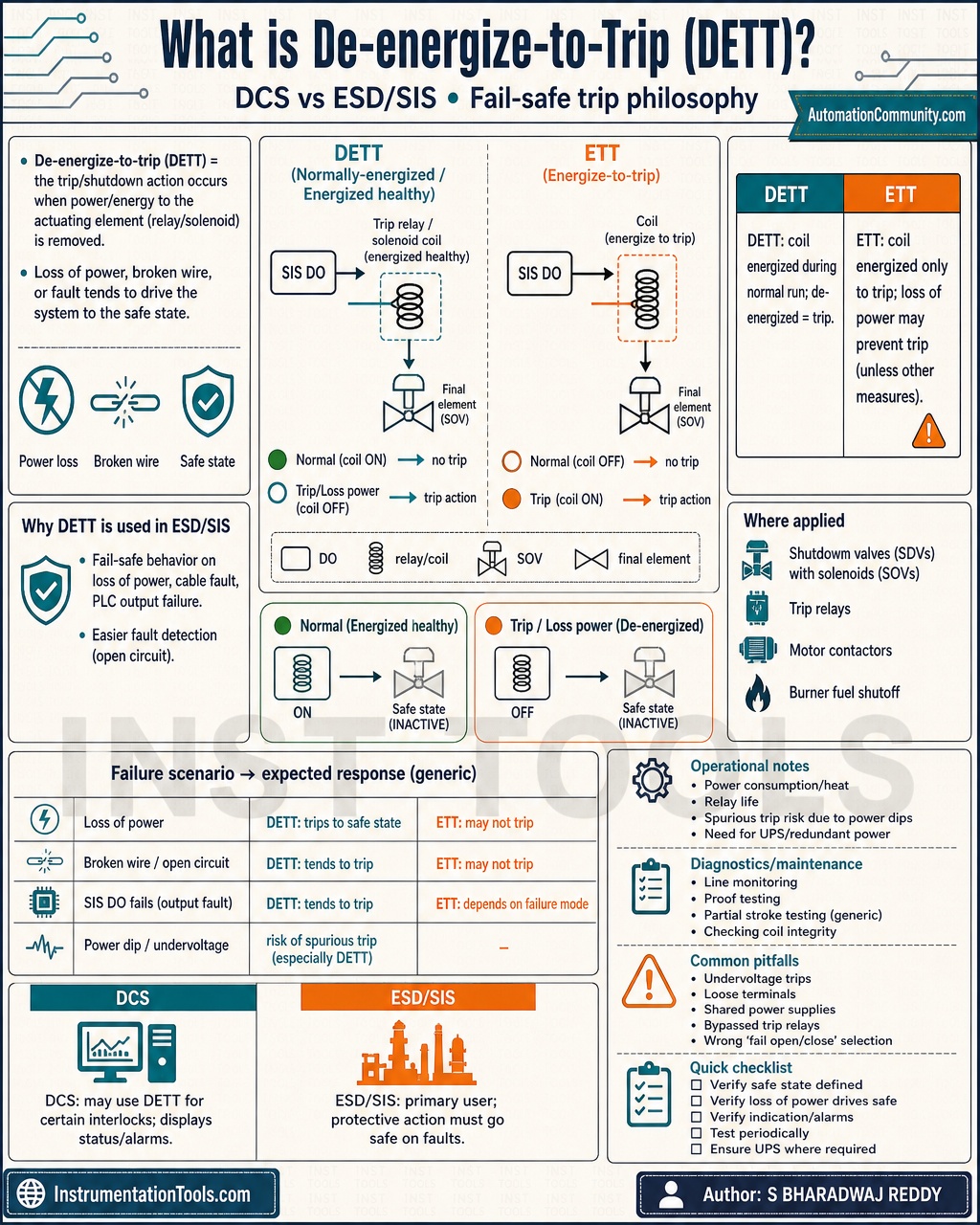

In a De-Energize-to-Trip (DTT) philosophy, the trip action occurs when the trip circuit or final element is de-energized.
In simple terms:
:electric_plug: De-energize β†’ Trip
This philosophy is widely used in ESD/SIS applications, especially where loss of electrical power or control energy is intended to place the process in a safe state.
:small_blue_diamond: How Does DTT Work?
Consider an ESD output controlling a shutdown solenoid:
ESD Logic β†’ Output β†’ Solenoid β†’ Shutdown Valve
During a healthy condition:
:green_circle: Solenoid energized
:down_arrow:
:green_circle: Shutdown valve remains in its normal operating condition
When a trip occurs:
:police_car_light: Trip condition detected
:down_arrow:
:electric_plug: Solenoid de-energizes
:down_arrow:
:locked: Shutdown valve moves to its defined fail-safe position
:down_arrow:
:shield: Process moves toward the safe state
:high_voltage: Example: Emergency Shutdown
Suppose a gas supply valve must close during an ESD.
Normal operation:
ESD healthy β†’ Solenoid energized β†’ Valve open
Emergency:
ESD trip β†’ Solenoid de-energized β†’ Valve closes
The valve may be designed Fail Close (FC) so that loss of actuator energy causes it to close.

:vs_button: DTT vs ETT
DTT :electric_plug: ETT :high_voltage:
De-energization causes trip Energization causes trip
Healthy state commonly requires energized trip circuit Trip requires energy to be applied
Loss of power can initiate trip Loss of power may prevent trip
Can provide fail-safe response to loss of energy Can have different failure behavior
Common in many ESD/SIS applications Used where the safety analysis/design justifies it
