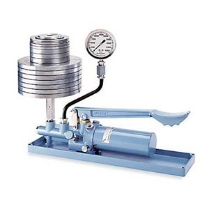

These are the most accurate pressure gages, so they are used mostly for calibration of other pressure gages or for measurements, when high accuracy is required (for scientific purposes).

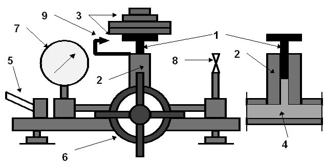

The accuracy achieved may vary from ±0.01 to ±0.02% of the measuring pressure (these instruments are used for calibration of dead-weight pressure gages), those with the accuracy of ±0.05% are used for calibration of other types of pressure gages. The range of measured pressures varies from 0.1 to 250 MPa. Figure 1 shows a schematic of a dead-weight pressure gauge.
A cylindrical piston 1 is placed inside a stainless-steel cylinder 2. The measuring pressure is supplied through the vent 8 to the fluid 4 of this gauge. To avoid contact of a measured media with the fluid in the gauge, “U”-shape separating tubes (made of stainless steel with a thick wall) are used. These tubes are filled by one half of their volume with mercury. The measuring pressure spreads throughout the fluid in the dead-weight gauge system. Transformer mineral oil and castor oil are used for measurements of low (up to 6 MPa) and high (up to 250 MPa) pressures, respectively. The measuring pressure by acting on the piston develops a force, which tends to bring the piston upwards.
The gravitational force developed by calibrated weights 3 can balance this force and the piston itself. This force acts downwards. The balance should be achieved for a certain position of the piston against a pointer 9 of the stainless-steel cylinder. A manual piston pump 5 is used to achieve approximate force balance (to increase pressure in the system), whereas a wheel-type piston pump 6 serves for accurate balancing. A Bourdon-type pressure gauge 7 is used for visual reading of pressure, but not for pressure measurements in this case.
Thus measuring pressure can be evaluated using the formula:
where, P - measuring pressure, Pa; mp - mass of the piston, kg; mw - mass of calibrated weights, kg; gloc - local gravitational acceleration,m/s2; Sp - cross-section area of the piston, m2.
