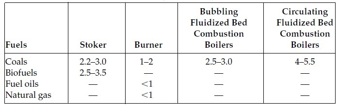

The furnace height is decided by firing device type and residence time necessity of specific fuel or volume of furnace. The following table presents a information about furnace residence time for some fuels. Residence time is needed with regard to a particle of fuel to achieve the middle point of furnace exit opening out of the firing device (Centre of heat input, should be accurate), supposing the entire furnace for being at isothermal of Furnace exit gas temperature. The furnace length is determined by flame while the furnace cross section is determined by burners; these considerations are very suitable for design furnace dimension of package boiler which has configuration of gas flow horizontally.

Table 1: Variety of Furnace Residence Times pertaining to Several Fuels (in Seconds)
(Source: Book-Boiler for Power and Process-Kumar Rayaprolu)
