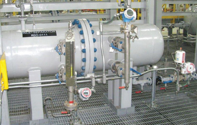

I would like to install a wash oil injection facility,
1. What is the type of FT used to measure flow & Level (LT) and wash oil piping for wash oil POT?
2. To design the wash oil POT, we plan to inject 500 kg / hr into the compressor,
How much is the temperature and pressure of the POT ideal for the design? I designed it as a program.
(diameter: 900mm, height: about 3000)

(2) LT / FT Type
If you need to accurately measure the level and flow rate, you will need a sensor that can measure 0-100% level, flow 0-100%, but it is not that you have to tell the tank’s low level or high level, If you need to figure it out, it will be very low if you choose Level Switch. If the oil tank is always filled and the driver is checking daily, the low level switch should be used to ring the low oil alarm and compensate the driver accordingly.
In case of Flow Sensor, if you only need to know whether flow of wash oil is flow, you can leave Flow Switch. However, if you need to set the flow rate to a few kilograms / h, you should configure the system with a combination of flow sensor and control valve.
The oil switch attached to the machine usually uses the Flow Swith and if you do not detect flow, you can equip the Interlock so that it will not start even if you press the Main Motor Power Switch. As flow sensor is various, cheap and various flow switch is commercialized.
