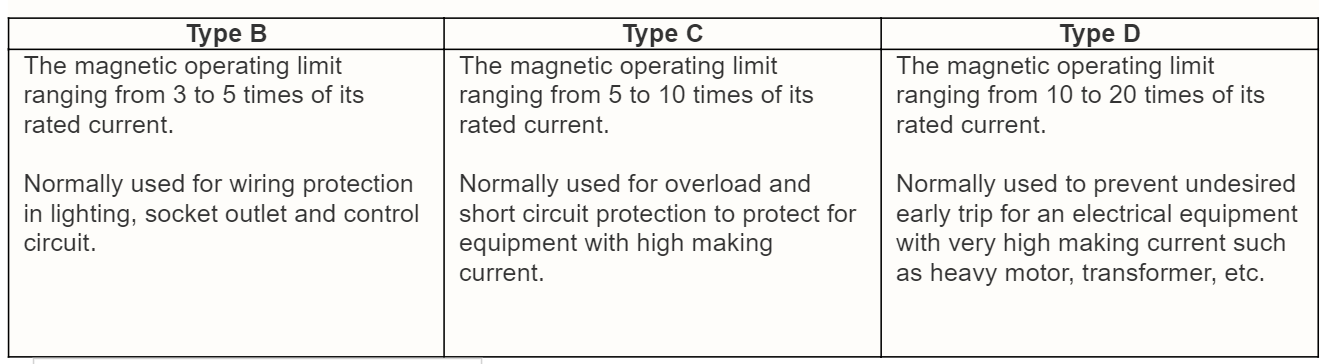

Below are the comparison between MCCB type B, C and D.
1331×364 44.8 KB
