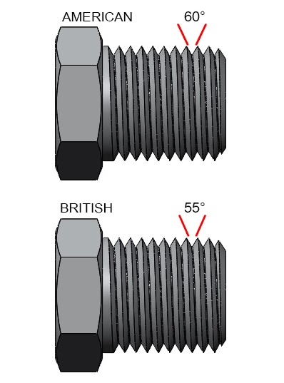

Thread angle or included angle
- NPT threads have a 60-degree angle
- BSPT threads have a 55-degree angle
Thread shape
- NPT threads have flattened peaks and valleys
- BSPT threads have rounded peaks and valleys
Thread pitch (TPI, threads per inch)
- Each NPT and BSPT pipe thread size has a specific number of threads per inch
