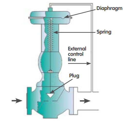

Direct Operated Downstream Pressure Regulating Valves Working Principle
In operation, a direct operated, pressure reducing regulator senses the downstream pressure through either internal pressure registration or an external control line. This downstream pressure opposes a spring which moves the diaphragm and valve plug to change the size of the flow path through the regulator.
Characteristically direct operator regulators are adequate for narrow-range control, and where the allowable change in output pressure can be 10 to 20% of the outlet pressure setting. This 10 to 20% is typical although finer control can be achieved depending on the specific application requirement.
