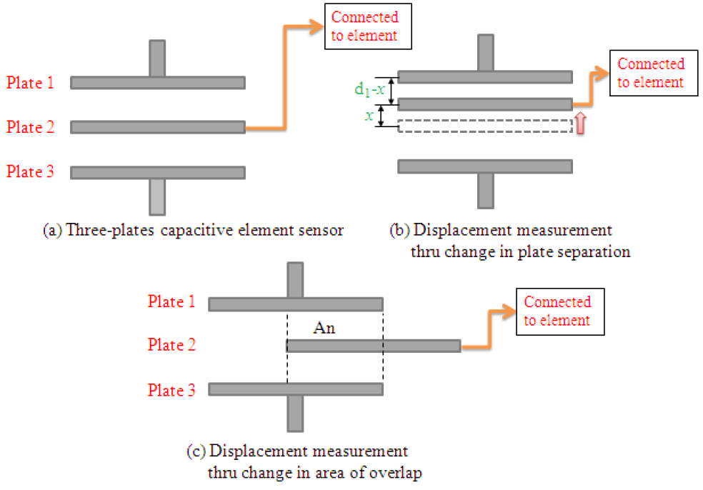

It comprises of three plates, with the upper pair forming one capacitor and the lower pair another. The linear displacement might take in two forms:
a. one of the plates is moved by the displacement so that the plate separation changes
b. area of overlap changes due to the displacement.
Capacitive Element Sensor
Below Figure shows the schematic of three-plate capacitive element sensor and displacement measurement of a mechanical element connected to the plate 2.
The capacitance C of a parallel plate capacitor is given by,
C = εr εo A / d
where εr is the relative permittivity of the dielectric between the plates, εo permittivity of free space, A area of overlap between two plates and d the plate separation.
As the central plate moves near to top plate or bottom one due to the movement of the element/workpiece of which displacement is to be measured, separation in between the plate changes. This can be given as,
**C1 = (εr εo A) / (d + x) **
C2 = (εr εo A) / (d – x)
When C1 and C2 are connected to a Wheatsone’s bridge, then the resulting out-of-balance voltage would be in proportional to displacement x.
