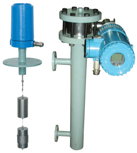

This method is based on the application of the Archimedes’ principle: every body immersed in the liquid or gas is exposed to the action of a buoyant force (sometimes called as the Archimedes’ force), which acts upwards.
This force is equal to the weight of the liquid, gas or vapour displaced by this body. The immersed body is called a buoy, thus giving the name to the method of measurement. Fig. presents a schematic of this type of device.
To measure the level of liquid 1 in a tank 2 a buoy 3 is partly immersed in the liquid. When the level varies so does the resultant force acting on the buoyancy/displacer.
The displacer element, buoy, is a cylinder of a constant cross-section area, and its density is greater than that of the liquid. The buoy moves up or down, depending on the level variation. The resultant force through a lever 4 is converted by a force-balance or electronic transmitter 5 to a proportional pneumatic (20-100 kPa) or electrical (4-20 mA dc) signal, which is transmitted by the distance. It means that for each value of the level in the tank will correspond the certain value of an output signal.
The length, diameter, material of the buoy and transmission ratio can be changed to suit various spans and various liquids. These instruments are used for measurements of liquid level and interface providing the level to vary within the length of the buoy, and for density measurements providing the buoy is fully immersed in liquid in the entire range of measured densities.
