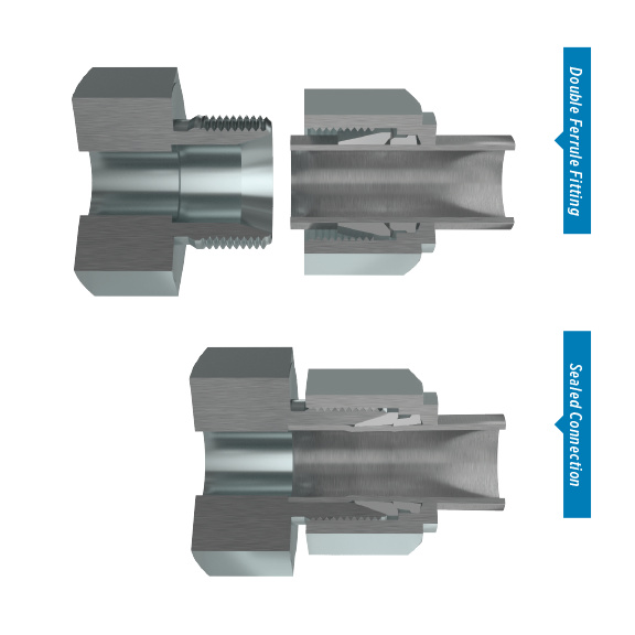

The male end of a double-ferrule instrumentation fitting has a recessed counter-bore which matches the tube OD being used, plus an inner cone.
The seal is made between the front ferrule and the cone. The tubing is held in place by the swaging action caused by the tightening of the nut, which forces the front and back ferrules to bite into the tubing, firmly holding it in place. This allows for the use of un-flared tubing with these connectors.
