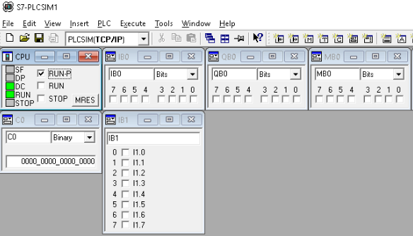

S7-PLCSIM allows you to run multiple instances, which can even communicate with each other.
NettoPLCSIM is a software utility that you can use to “network enable” your S7-PLCSIM V5.4 simulatot. This allows software on another computer or another PLC to communicate to the S7-PLCSIM via Ethernet.
Link: NetToPLCsim – Network extension for Plcsim
