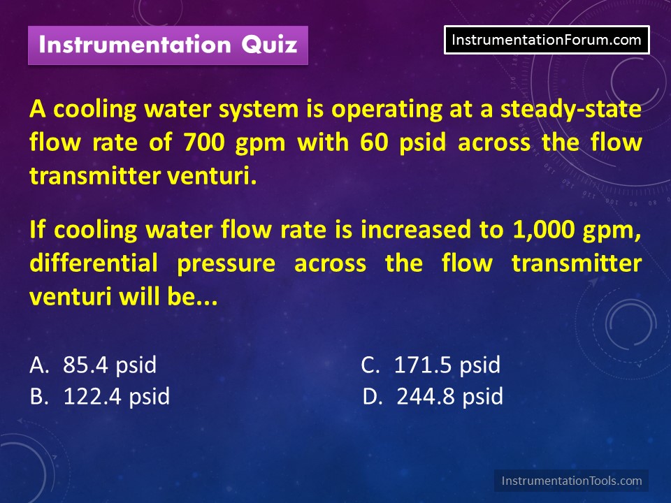

DP across Venturi Flow Meter
A cooling water system is operating at a steady-state flow rate of 700 gpm with 60 psid across the flow transmitter venturi.
If cooling water flow rate is increased to 1,000 gpm, differential pressure across the flow transmitter venturi will be…
A. 85.7 psid.
B. 122.4 psid.
C. 171.4 psid.
D. 244.8 psid.
ANSWER: B.
