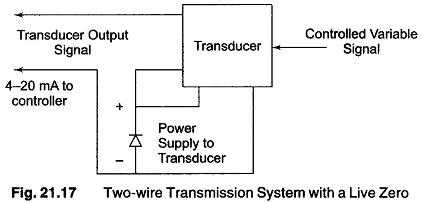

The range of current values used varies widely, typically ranges being 0 — 10 mA, 0 — 20 mA, and 4 — 20 mA. The live zero of 4 mA permits transducers to use the line characteristic as a source of power for its amplifier as shown in Fig. 21.17.
By this means, a transmission system is obtained. A disadvantage of the line zero is that the controlled variable zero does not correspond to a true zero of the transmitted current. This presents problems where mathematical operations, e.g. a square root function, have to be carried out on the current.
