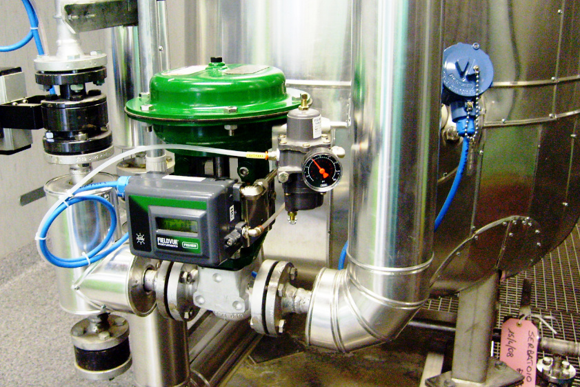

Final control elements are devices that complete the control loop. They link the output of the controlling elements with their processes. Some final control elements are designed for specific applications.
For example, neutron-absorbing control rods of a reactor are specifically designed to regulate neutron-power level; however, the majority of final control elements are general application devices such as valves, dampers, pumps, and electric heaters. Valves and dampers have similar functions. Valves regulate flow rate of a liquid while dampers regulate flow of air and gases. Pumps, like valves, can be used to control flow of a fluid. Heaters are used to control temperature.
These devices can be arranged to provide a type of on-off control to maintain a variable between maximum and minimum values. This is accomplished by opening and shutting valves or dampers or energizing and de-energizing pumps or heaters. These devices can also be modulated over a given operating band to provide a proportional control. This is accomplished by positioning valves or dampers, varying the speed of a pump, or regulating the current through an electric heater. There are many options to a process control. Of the final control elements discussed, the most widely used in power plants are valves. Valves can be easily adapted to control liquid level in a tank, temperature of a heat exchanger, or flow rate.
Final Control Elements–Control Valves. Process control engineers tend to treat final control elements in the same way they treat measurement devices–with absolute indifference. To most of them, a valve is a valve is a valve. Its job is to open and close according to what the controller tells it and it does just that.
The problem is, in a shocking number of cases, it does not. Control valves and dampers, being mechanical devices, are subjected to a lot of mechanical issues like wear and tear – deterioration with time.
Present measurement devices are very robust and most do not deteriorate drastically with time. The controller running inside the modern distributed control system (DCS) is even more reliable with a hot standby ready to take over in case of failure.
The same cannot be said about final control elements. Therefore the weakest link in the process control loop is frequently the final control element.
The problems of control valves usually manifest as deadband, stiction, and hysteresis.
