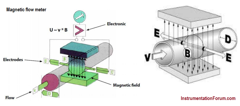

Magnetic flow meter
To apply this principle to flow measurement with a magnetic flowmeter, it is necessary first to state that the fluid being measured must be electrically conductive.
As applied to the design of magnetic flowmeters, Faraday’s Law indicates that signal voltage (E) is dependent on the average liquid velocity (V) the magnetic field strength (B) and the length of the conductor (L) (which in this instance is the distance between the electrodes).
Construction:
The magnetic flowmeter consists of an electrically insulated or non conducting pipe such as fiber glass.
A pair of electrodes mounted opposite to each other and flush with the inside walls of its pipe
Magnetic coil mounted around the pipe so that a magnetic field is generated in a plane mutually perpendicular to the axis of the flowmeter body and to the plane of electrodes.
If a metal pipe is used, an electrically insulating liner is provided to the inside of the pipe. A cut way view of the magnetic flow meter is shown in Fig. 1.
Flowing liquid acts as the conductor, the length L is the distance between the electrodes and equals to the pipe diameter.
The magnetic coils may energized either by AC or DC voltage, but the recent development is the pulse DC-type in which the magnetic coils are periodically energized.
Working:
As conductive fluid passes through the electrodes and magnetic field, voltage is generated at tip of electrodes.
Magnetic meters are available in sizes from 2.54 to 2540 mm in diameter, with an accuracy range ±1/2 to ±2%. The rangeability of such meters may be 30:1, however, normally accepted range is about 20:1. The measurement of these meters are independent of viscosity, density, temperature and pressure.
In a new design of magnetic flowmeter, it can be inserted into the line through couplings. It consists of electrodes mounted on each side of the probe and magnetic coils which are also integral to the probe. The probe can be mounted on pipes of any size, and can easily be mounted for open channel flow.
