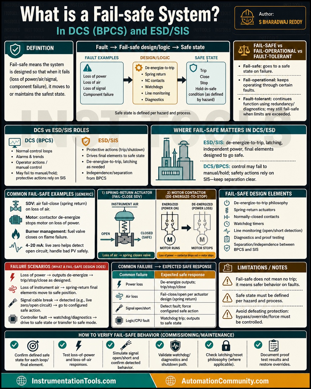

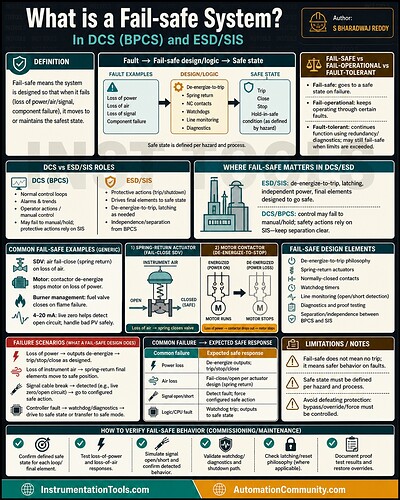

Fail-safe system
A system failure does not always mean the process should simply stop.
In a fail-safe system, the design ensures that when a specified failure occurs, the equipment or process moves to, or remains in, a predefined safe state.
:small_blue_diamond: What is a Fail-Safe System?
A fail-safe system is designed so that, under specified failure conditions, the system responds in a way that minimizes the risk to people, equipment, and the environment.
In simple terms:
:warning: Failure β†’ Defined safe response β†’ Risk reduced :shield:
:factory: Example: Emergency Shutdown Valve
Consider a shutdown valve installed on a fuel-gas line.
If the safe condition requires the gas supply to be isolated:
:police_car_light: Dangerous condition / loss of required actuation energy
:down_arrow:
:locked: Shutdown valve closes
:down_arrow:
:no_entry: Fuel supply isolated
This is commonly described as a Fail-Close (FC) arrangement.
Other fail positions can include:
:unlocked: Fail Open (FO)
:pause_button: Fail in Place (FIP)
The appropriate fail position depends on the hazard analysis and required safe state.
:high_voltage: Example: De-Energize-to-Trip
A common safety philosophy is:
Healthy condition β†’ Energized
Trip condition / specified failure β†’ De-energized
For example:
:green_circle: Relay energized β†’ Equipment permitted to run
:high_voltage: Loss of power / trip signal
:down_arrow:
:red_circle: Relay de-energizes
:down_arrow:
:stop_sign: Equipment trips
This can help make certain failures detectable and drive the system toward the intended safe response.
:fire: Examples of Fail-Safe Behavior
Loss of instrument air:
:dashing_away: Air lost β†’ Valve moves to its designed fail position
Loss of electrical power:
:high_voltage: Power lost β†’ Equipment moves to a predefined safe condition, where the design supports this behavior
Emergency shutdown:
:police_car_light: ESD demand β†’ Final elements move to their defined safe positions
:warning: Very Important
Fail-safe does NOT mean failure cannot occur.
It means the system has been designed so that specified failures result in a defined response intended to reduce risk.
Also, fail-safe is not the same as fault-tolerant.
:shield: Fail-Safe:
Failure β†’ Move toward safe state.
:counterclockwise_arrows_button: Fault-Tolerant:
Fault occurs β†’ Continue performing the required function despite the fault.
:bullseye: Interview Question
What is a fail-safe system?
:backhand_index_pointing_right: A fail-safe system is designed so that, when specified failures or hazardous conditions occur, it automatically transitions to or maintains a predefined safe state intended to minimize risk.
:light_bulb: Remember:
:police_car_light: Don’t ask only, β€œWhat happens when the system works?”
:shield: A good safety design also asks, β€œWhat happens when something fails?”
