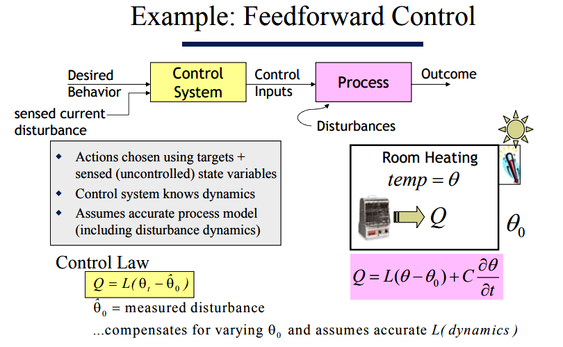

In feedforward control, a sensor is used to detect process load changes or disturbances as they enter the system. A block diagram of a typical feed- forward control loop is shown in the following Figure. Sensors measure the values of the load variables, and a computer calculates the correct control signal for the existing load conditions and process set point…
